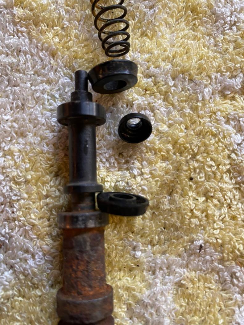

                  Hi Jim, I did put a wire in the spooge hole to clean it but didn't follow up to check if I can see through it. I will do that. Also, in the attached picture, are the parts in the correct order? I lost track and not sure if goes plunger, rubber washer, cap, spring, or plunger, cap, rubber washer, spring. Also is there a metal washer that goes in there somehow. I have attached a picture of what I think/hope is the correct order. Click image for larger version

                      The funny looking metal washer is in the wrong order in your picture, it goes between the outer rubber and the spring. The narrow end of the spring should fit onto the smaller end of the funny washer. The thin regular type washer goes on the piston before the outer rubber goes on.
                        Ditto on what Phil said and I would suggest that you buy a rebuild kit for that master. The plunger is fairly rusted on the one end. The kits come with a new one.
