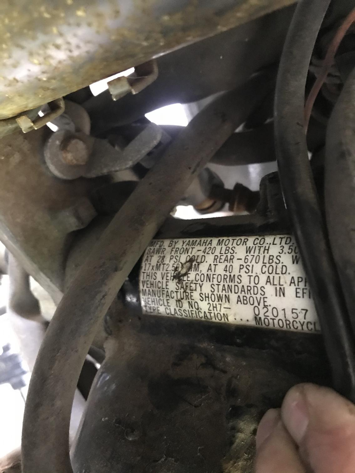

      Ok. I couldn’t find the kickstart lever. I bought one from a guy on FB. I did take a picture of the VIN. I’m not sure what it means. I know I need side covers. Here is the VIN:

          2h7 signifies that you have a standard. You can download a manual. If you frequent Ebay you can usually find a hardcopy for sale. As for the key, just look on the ignition for the four digit code. I have never owned a standard, so I am not really sure about that code. It is on the specials. Anyway... go on Ebay and search Yamaha and that 4 digit code and it will bring up keys. There are several folks out there that supply blanks as well as those that sell the blanks and cut the keys according to the code you give them. I picked up a MNS back in October with no keys and a vendor on Ebay supplied and cut two keys for a bit under 20.00. I would suggest that you completely rebuild every aspect of the brakes. Rebuild kits for the masters and the calipers. Search for Brake Crafters. Go with the kits with new stainless pistons. A bit more but you will never have to worry about them again. Also replace all the old brake lines with stainless clad in vinyl. Good luck on the resto and we love pictures and everyone is willing to help.
