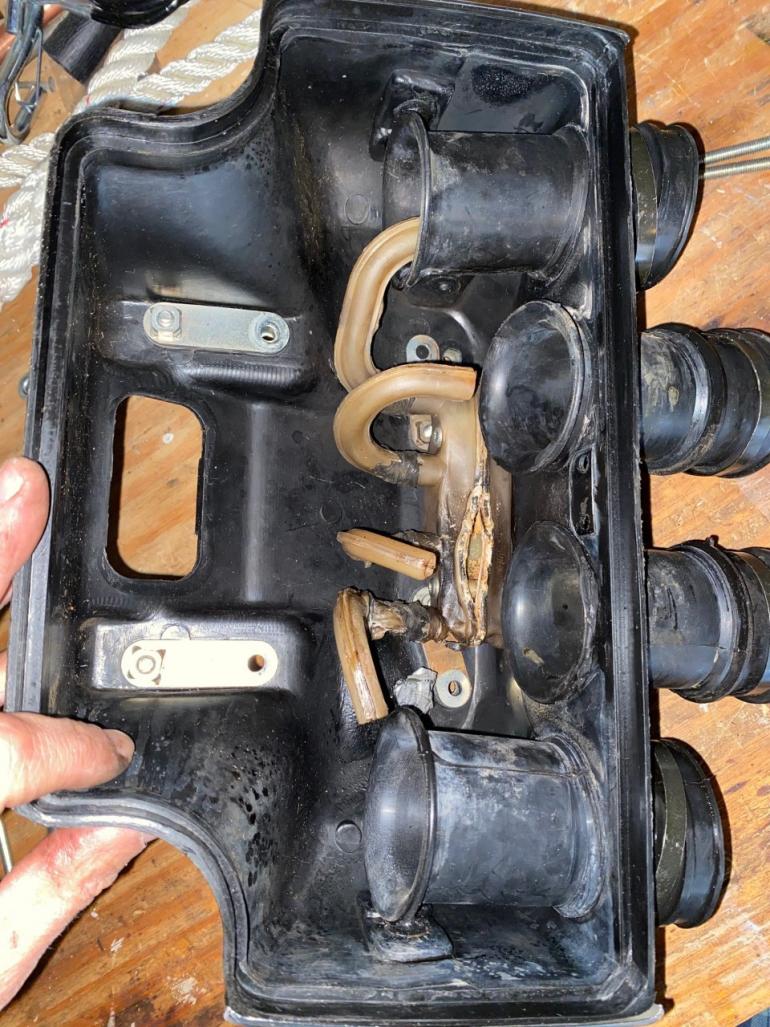

    My brother in law and I are working on our first restoration, a 1978 XS1100 bought from original owner with 30k miles. It had been sitting for 14 years and wasn't running. Rebuilt carbs and petcock, changed plugs and did a few other things. It runs now but after riding and sitting overnight there was gas in the airbox. I checked both petcocks and they do not leak gas when in the "ON" position. So I tried to see if one or more of the carbs was leaking by taking the airbox off, and putting both petcocks in "PRI". Thinking that if a float was stuck that carb would leak, but nothing leaked. Would like to try and figure out what carb is leaking before taking them off. Any suggestions how to determine that? One thing to note, the airbox looks like it had some melting at one point (from before we bought it). Does it need to be replaced? Could it be part of the problem?

              Not if the bike is running well, but it's still got problems. The '78 uses the airbox for clean vent air to the carbs. If the vents are plugged, you can have both not running well and flooding. Your airbox had a backfire and then flames from looking at it.

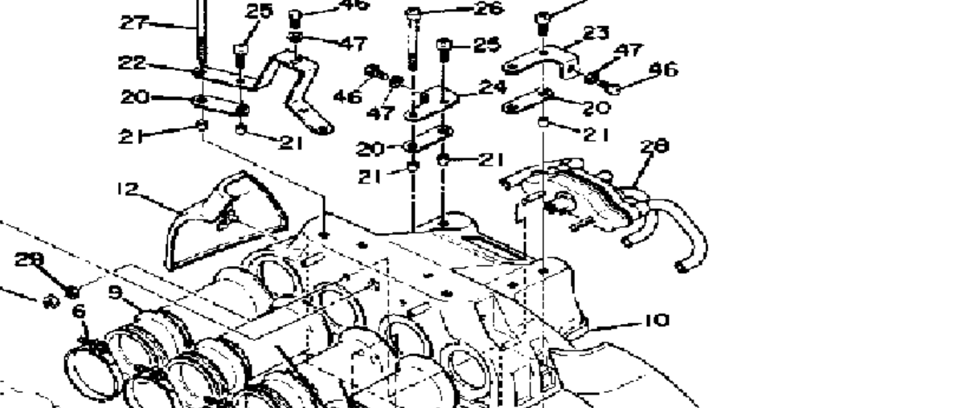

                          Probably a dumb question but the part in my air cleaner that is messed up (part 28) what exactly does it do? If I remove it what would happen?
                            The crankcase vent hose hooks up to that. #44 in this picture
                              Part #28 disperses the oily crankcase ventilation fumes from the crankcase evenly into intakes for each cylinder.
                              You want it there for a permanent installation but if you took it out until you got a new airbox, it would probably be OK,... but there might be an oily mess inside the airbox.
