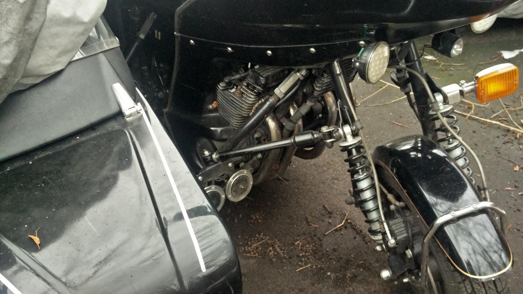

    Hi out there in xs1100 world im getting perilously close to finishing my 78 hack rebuild and one of the last items to go on is a replacment steering damper as the old one is dead , had a vw damper on there but im wondering if using a moto unit with variable input would work or if there is just to much force created for a moto unit to cope ? I was planning to not use a damper at all but (Full disclosure I have never ridden a sidecsr )after doing some recerch im getting a bit nervous about how they handle and thought I had better put one back on if that was how it was set up originally.
    any info greatly appreciated.

    You should use a damper.
    I have tried three different types on my xs1100 sidecar:
    first one from VW. To fit it I had to change the connections which didn't look good. Next I tried one from Mercedes. It fits perfectly without any alterations, but it is very hard. The last one is from Stabilus and it's perfect.
    I don't know whether you can buy it in US.
    You can buy one specially designed for sidecars
    from a company in Germany named MOBEC.
    Regards
    Rolf
