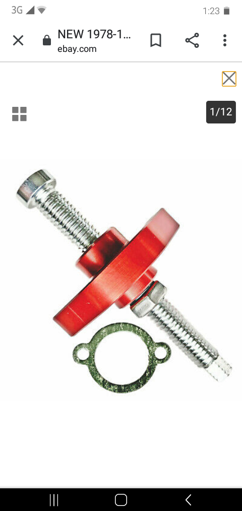

        Installed a manual cam chain adjuster and never looked back. Sounded like somebody dumped a bag of marbles into the crankcase. Original cam chain adjuster can back off when downshifting and create dangerous looseness. Something to consider. Also may contribute to noises - carb synchronization?

          The original CCT is a manual adjust... Did you mean ACCT is what you installed?

              Manual tensioner... Click image for larger version

                  Bonz - full manual adjuster - like bikerphil posted. Installation of that and replacing the cam chain made for a nice quiet, happy motor. Important to adjust it properly - overtight can be an issue, too.

                          Gotcha. The confusion came because guys that have been around here a long time typically swap in an automatic cam chain tensioner from a vision or virago or something similar. So when you say you installed a manual cam chain tensioner that typically is counter to what guys have done over the years.
