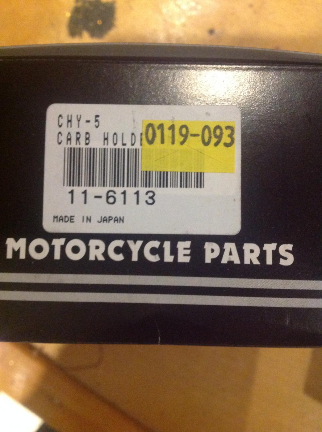

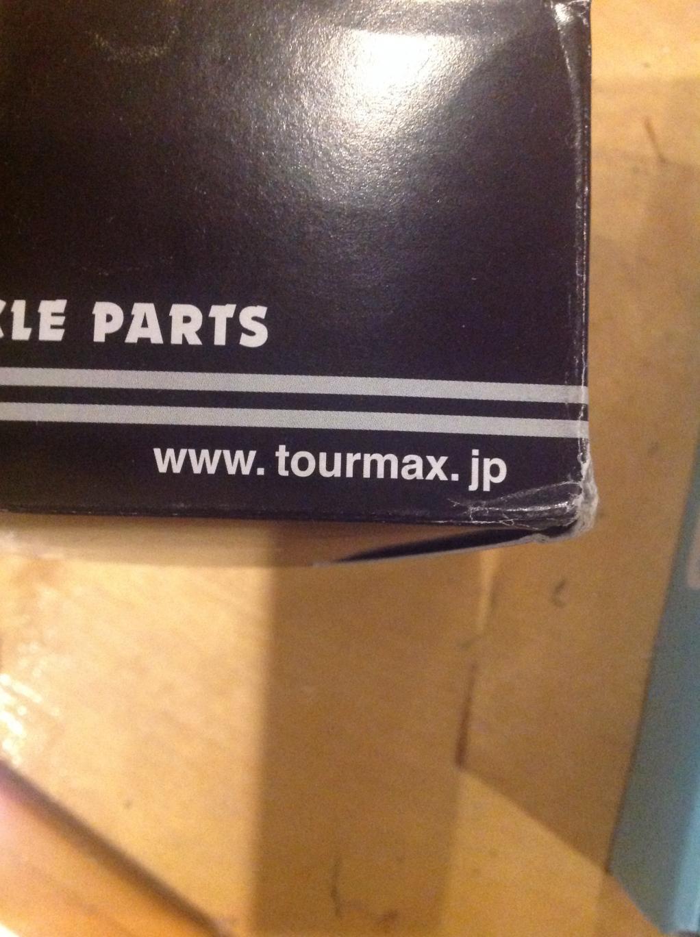

            Hello ! people, advise good boots , many options, you don't want to buy bad ones.
            forgive my english i am from distant russia,
            • Bax
              • 344
              • Merrimack, NH
              Hi Bormoley, the K&L brand seems to be packaged from tourmax. Part number 11-6113
              lots of counterfeit parts on the online market
              if I remember correctly, the last set I purchased was from Cruzin Image in Japan.
