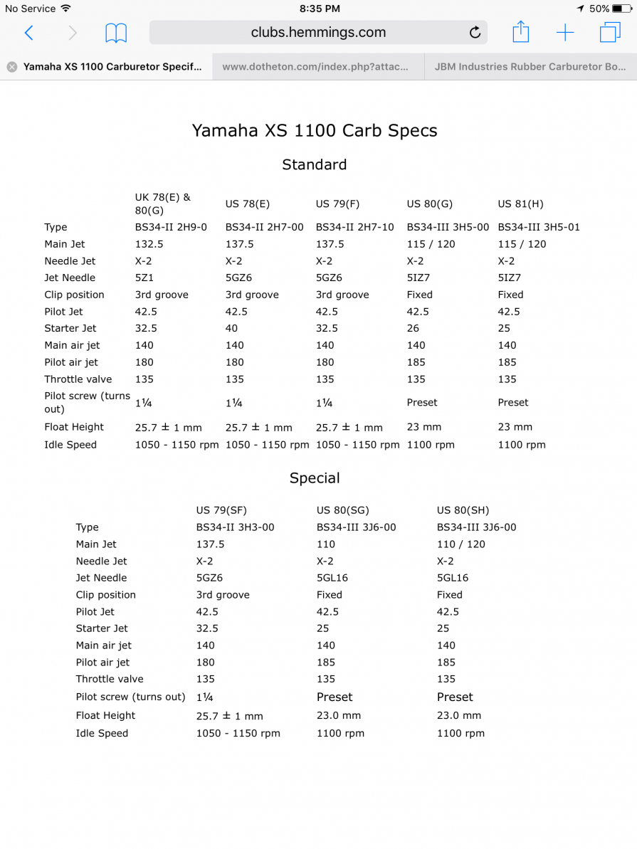

                          Then you should be running 110 to 120 Main jets. Not the 140’s. That’s your bog unless someone put older carbs on it. It’s been a few years since I rebuilt a set, but I I think 110 across all four, or 110’s on the outer carbs and 115’s on the inner carbs was stock on some.
                            Probably not to the main jet yet as Banshee indicated he's only gone a block or two in 2nd. I wouldn't expect the slide to raise quickly if bogging off idle.
                            here is the jetting chart
