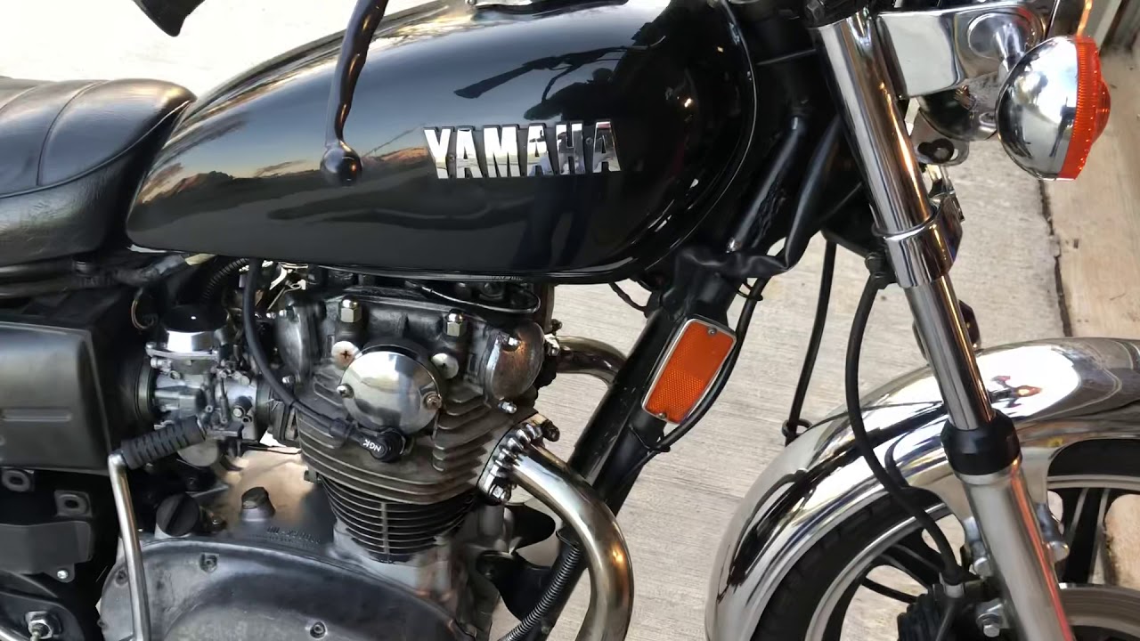

    I swapped in an engine on my XS650. It rattles. I posted the video below to XS650.com that I made with my iPhone. I had answers in minutes. We couldn't do that at XS11 dot com, but we can do it here!
      Something similar to that sound, I'll post a clip here soon

          The sound is very similar to jetmechmarty's video.

                That being an XS650, what's wrong with it has nothing to do with the XS11. The engine design is very different. I only posted it as an example of how to share the noise.
                The XS650 has shed the rubber from the forward cam chain guide foot. It's a very common issue on that bike. The tensioner, having run out of travel, confirms it.
