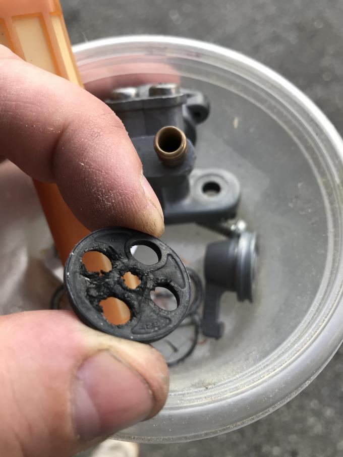

          This is what the seals usually look like after a few years.

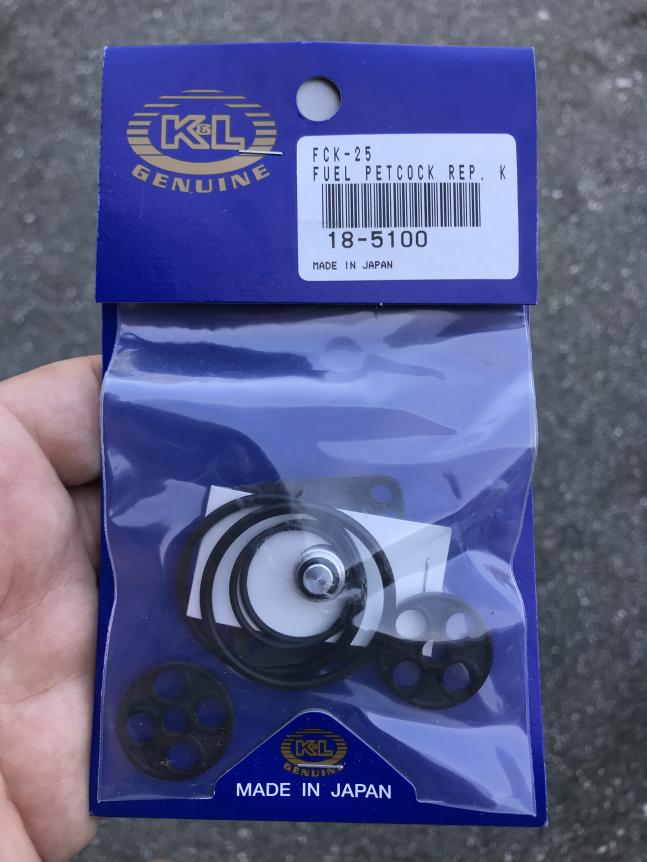

            K&L kit to repair has a flaw with the octy stem o ring being too small to seal against the valve seat. Replace this with a larger one, bit on is fuel compatible. Click image for larger version
ID:	859032The correct size is metric 2x4.5, I’ve used a 1/16 x 3/16 (2-008) and it worked for a few years, although it sits loose it did seal.

                I don't think we answered your Question as to "How the Petcock works"
                Referencing the K&L Kit that Bax posted for you and that plunger he is pointing to:
                Basically how it works:
                When that plunger with 'O' ring is engaged (static position with motor OFF) that plunger stops the flow of gas from the tank through the petcock to the fuel lines. But when you apply a vacuum to the vacuum port that vacuum on the opposite (back air side of the plunger) pulls out 1-2mm and allows the fuel to flow. Something like that ..................................
                Really very simple. Both age and ethanol gas eat up the rubber parts as Bax showed you.
                As Ray & Bax have said, if this is a new to you bike then I would buy the K&L kit and rebuild the Petcocks. Understand you have a "G" Standard.
                As Mike & BikerPhil commented your immediate problem is not likely the petcocks but we certainly recommend rebuilding them. Likely something goofy with the new Intakes or the condition of the Vac Lines.
