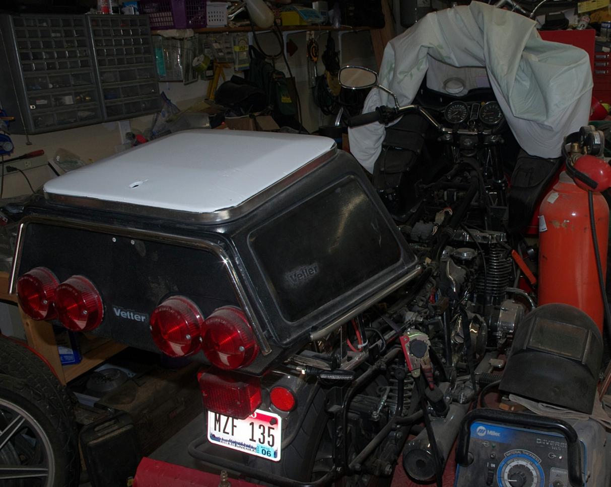

                The bike as it sits in the garage.

                I hope to paint the removable panels on the box the same color as the tank. The top may stay white, only to keep the temp down inside the box for long rides. I had something melt in there last summer!

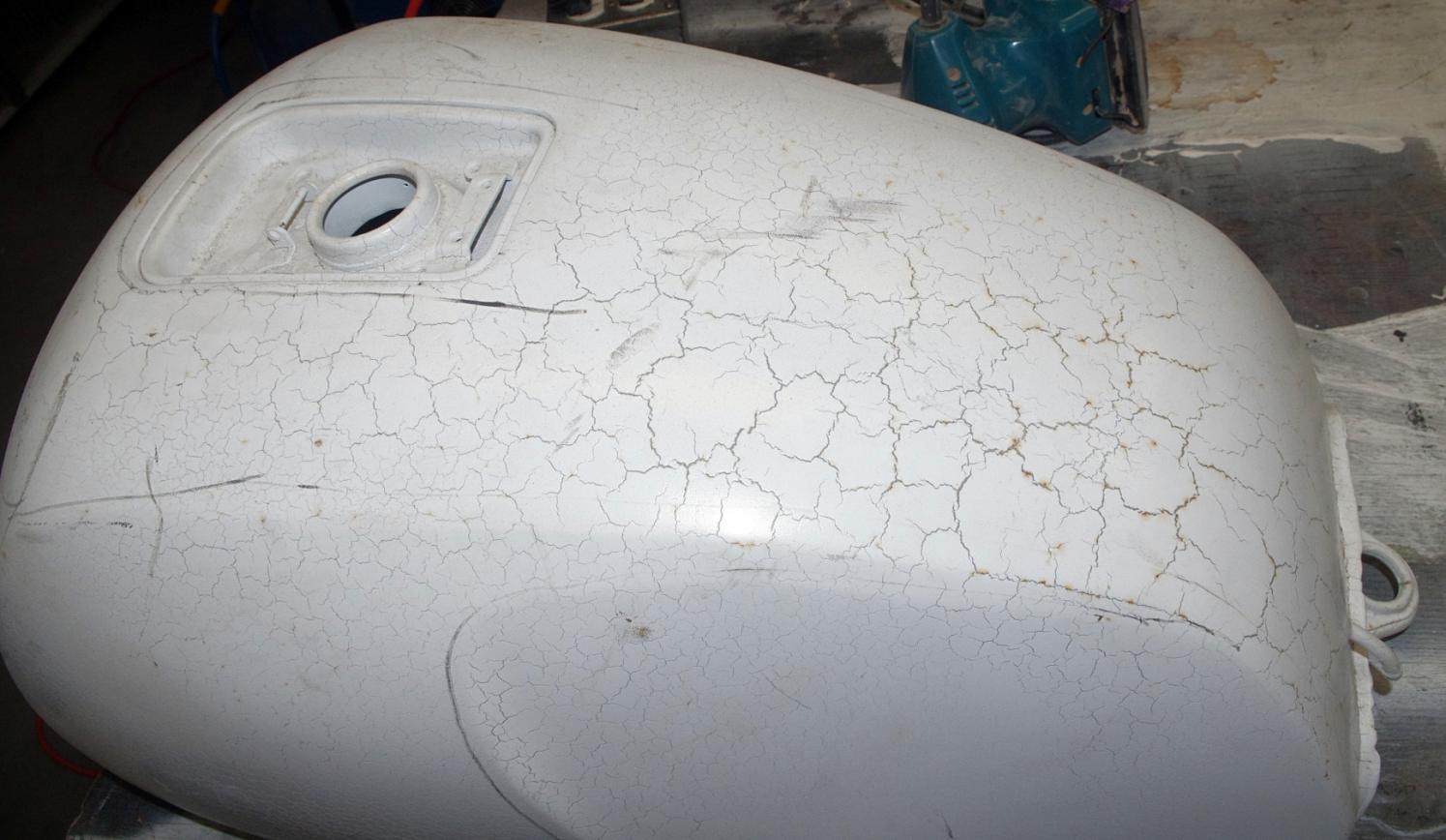

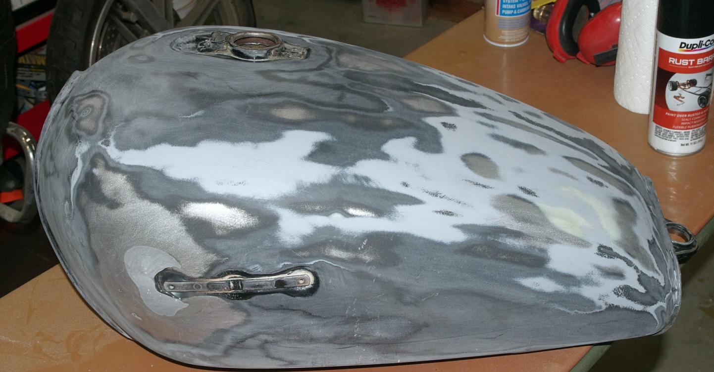

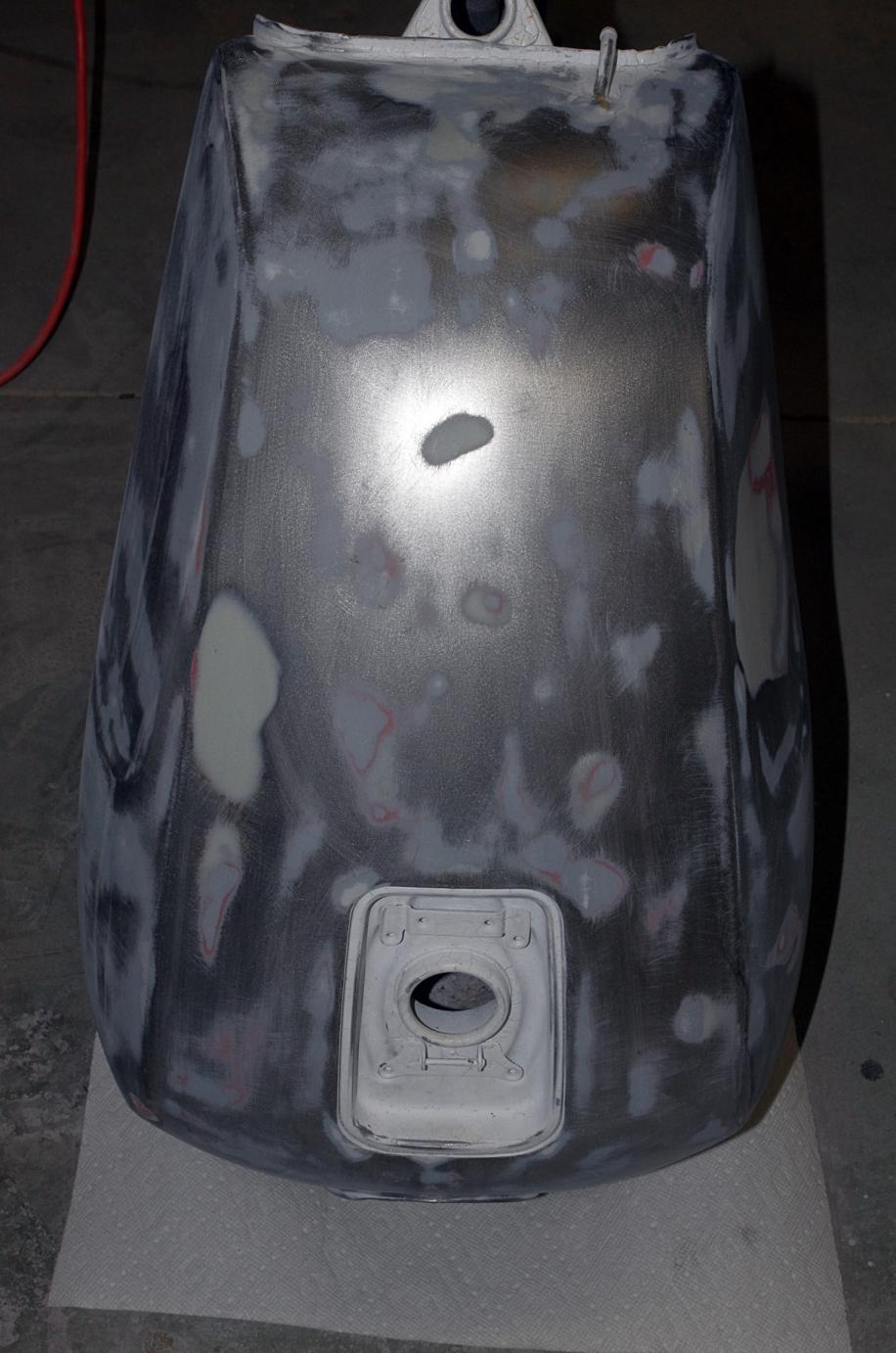

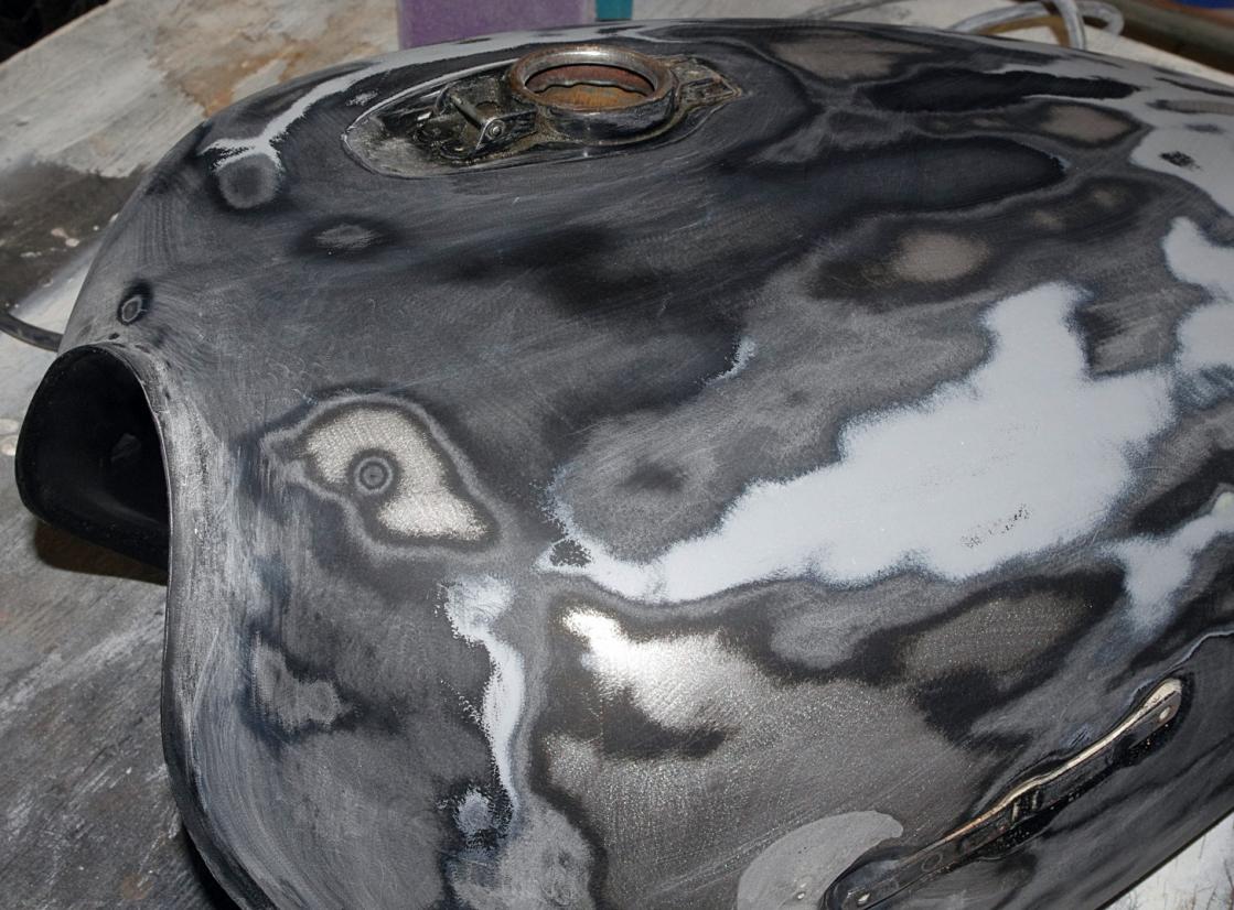

                        Done with the power sanding today! Two tanks, one I had started about 12 years ago, had the paint "go off" because I rushed it, and put the tank away. The second is the tank that was on the bike, and it had been re-painted and a dent repaired at some time.
ID:	862874 Click image for larger version
                        After the sanding and a cleaner they look almost ready for primer.
ID:	862876 Click image for larger version
                        You can see the layers of paint on the Special tank.
