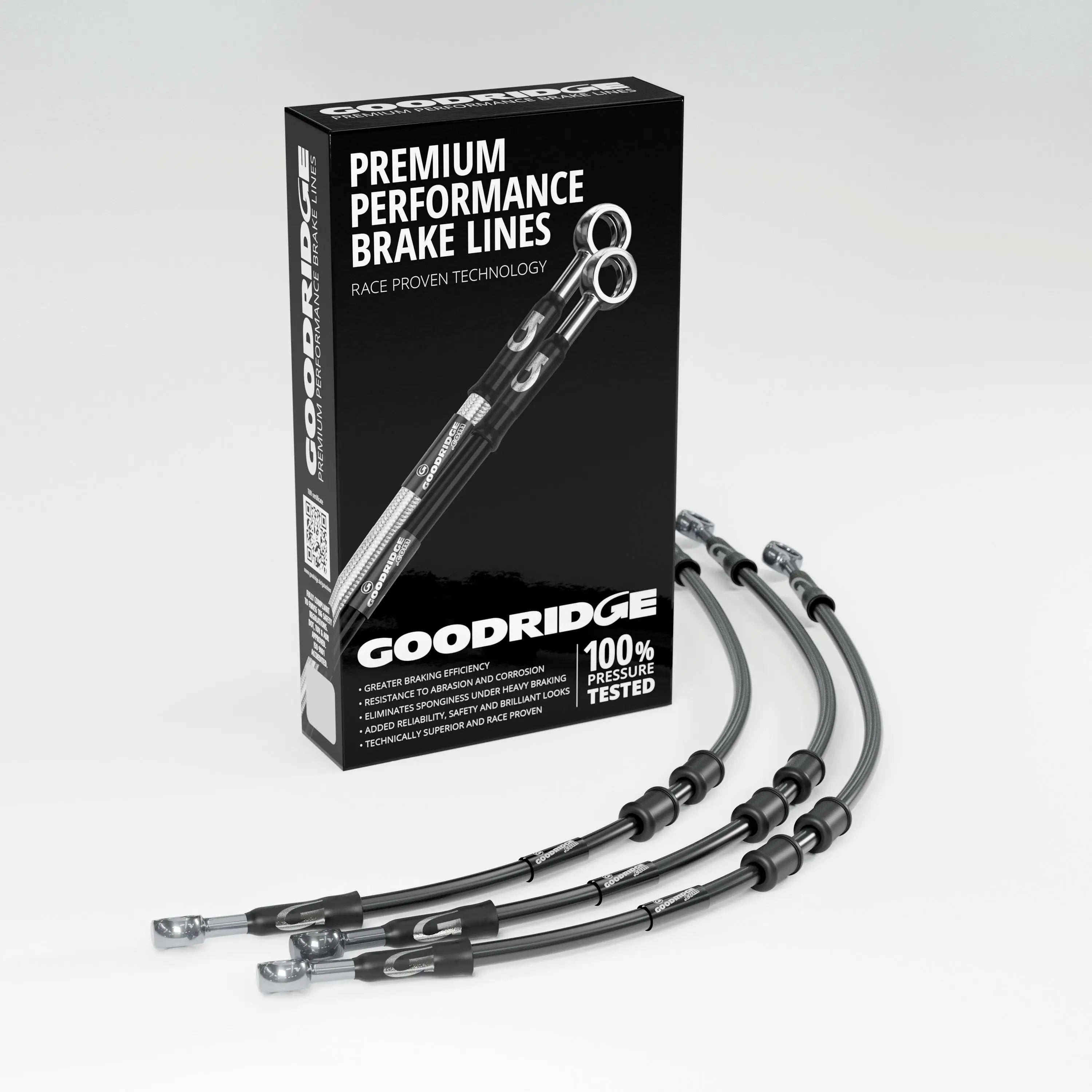

          I am also looking for brake lines and remembered Kurt recommending the Goodridge from UK. Front for the 78-80 XS1100 is $80 british pounds = $100 USD. Shipping about $20.
          I noticed the Technafit site says a four line kit for fronts. The Goodridge contact confirmed their kit is 3 line for front.
          I am going to measure and confirm befor ordering.

            I believe Technafit is 4 lines for the front and rear combined. 3 front, 1 rear.

              Yep, it is for front and back. My mistake.
