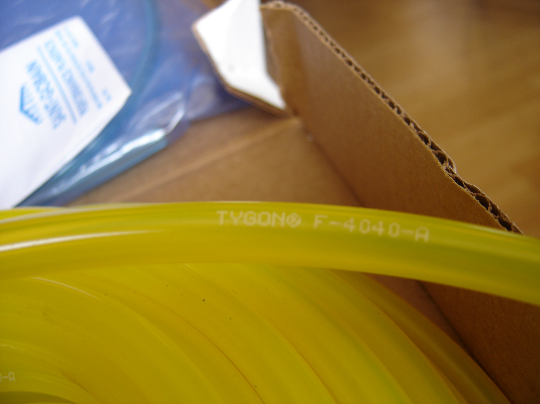

      I personally use the yellow tygon fuel line and like the ability to see the fuel flow.
      This link is where I found the best price for bulk tygon: https://www.saint-gobain-northameric...s/brands/tygon

            I have Tygon fuel line I bought on E Bay years ago. Good stuff, easy to work with and hardens up over time but it will take a while. The black fuel line sold in auto parts stores break down over time.
