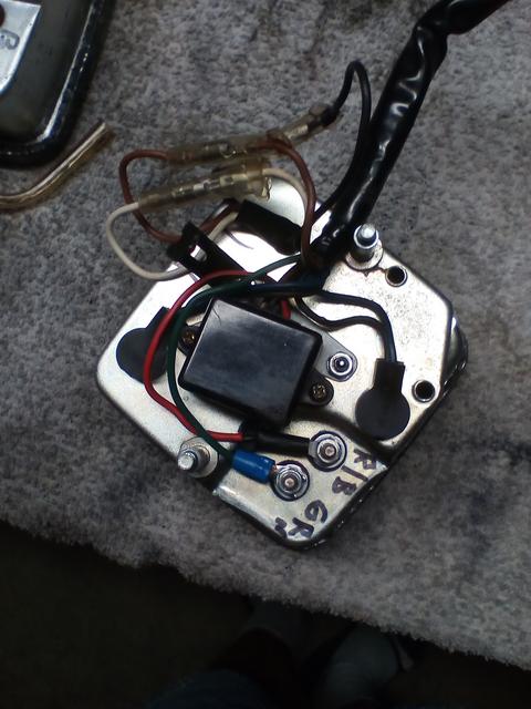

    Looking for one of these for a 79 Standard, any year will work. Anybody have an extra laying around in their parts pile? It's the black box shown below. Thanks.
    Meant to say fuel guage regulator.

          How did you figure out what the actual problem was? The gauge on my 79F has never worked. I would be very interested in learning about your diagnostic procedure. If I still had nice weather to ride in like some people I know, I likely wouldn't bother with it!
            I am rebuilding an extra Standard tach I bought it on eBay. The tach worked fine on my bike but not the fuel gauge. I removed the tach from the bike and placed it on the work bench. I removed the back cover. I used a 9V battery to test the gauge itself. The gauge moved with the battery applied. That narrowed it down to the regulator.
            If your fuel gauge never worked, it could also be lack if signal from the sending unit in the tank. If you look in the FSM there is a procedure for testing that.

                Just to follow up on this, I got a regulator from Andreas and all is good, gauge now works.
