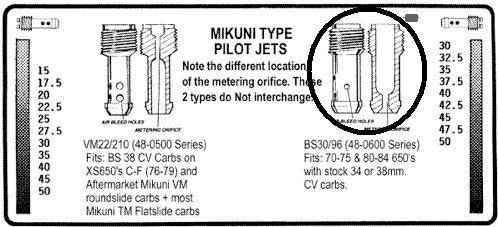

                                Double check your pilot jets and make sure they are the BS type and not the VM type, VM has the wrong spray pattern and will not work properly in the BS carbs, here are the 2 side by side...
                                If they are the correct ones, try a re-sync and proper idle mixture screw adjustment.
