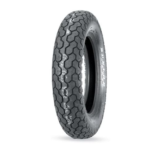

    I'm looking for new tires for the XS1100SF. I was just wondering if anyone has used a classic/vintage style tire on there bike. An example I was looking at are the Continental RB2/K112 or Dunlop K70. Any tires out there in that style that would fit the XS1100SF? Thanks.

        Dunlop K491
        I've been running these since the early 80's. I love 'em.

                The Dunlop K70 is available in 3.50x19 front, but no matching rear tire in your size.
