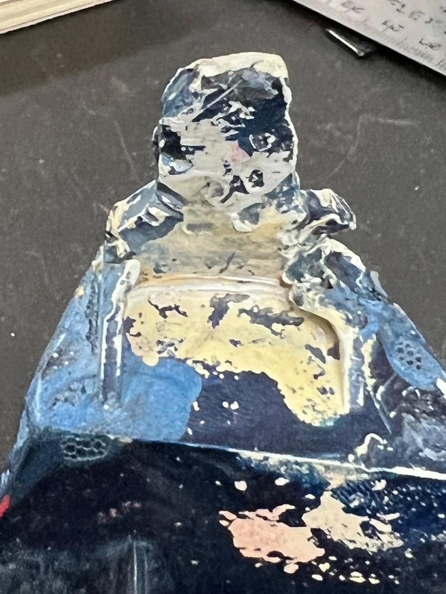

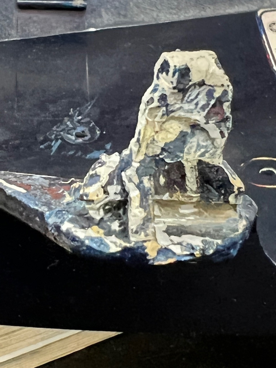

            Hello Everyone,
            I am reviving this old thread in hopes that somebody can provide the OP's requested information - detailed photos/drawing/measurements - of an intact left side cover post. I too have a decent battery side cover, with a broken locking tab. I also believe that if I had measurements or a rough outline of this Post's shape and profile, I could fabricate one. (Evidently the member who once offered a replacement post service is unreachable.)
            I have cleaned up the locking mechanism and it works just fine, so all that's left is making a post...
            Thanks in advance for your assistance!
            Rocky

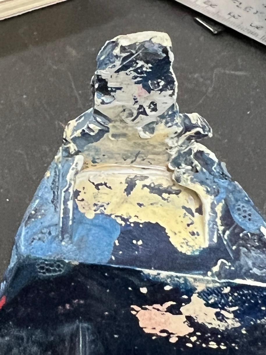

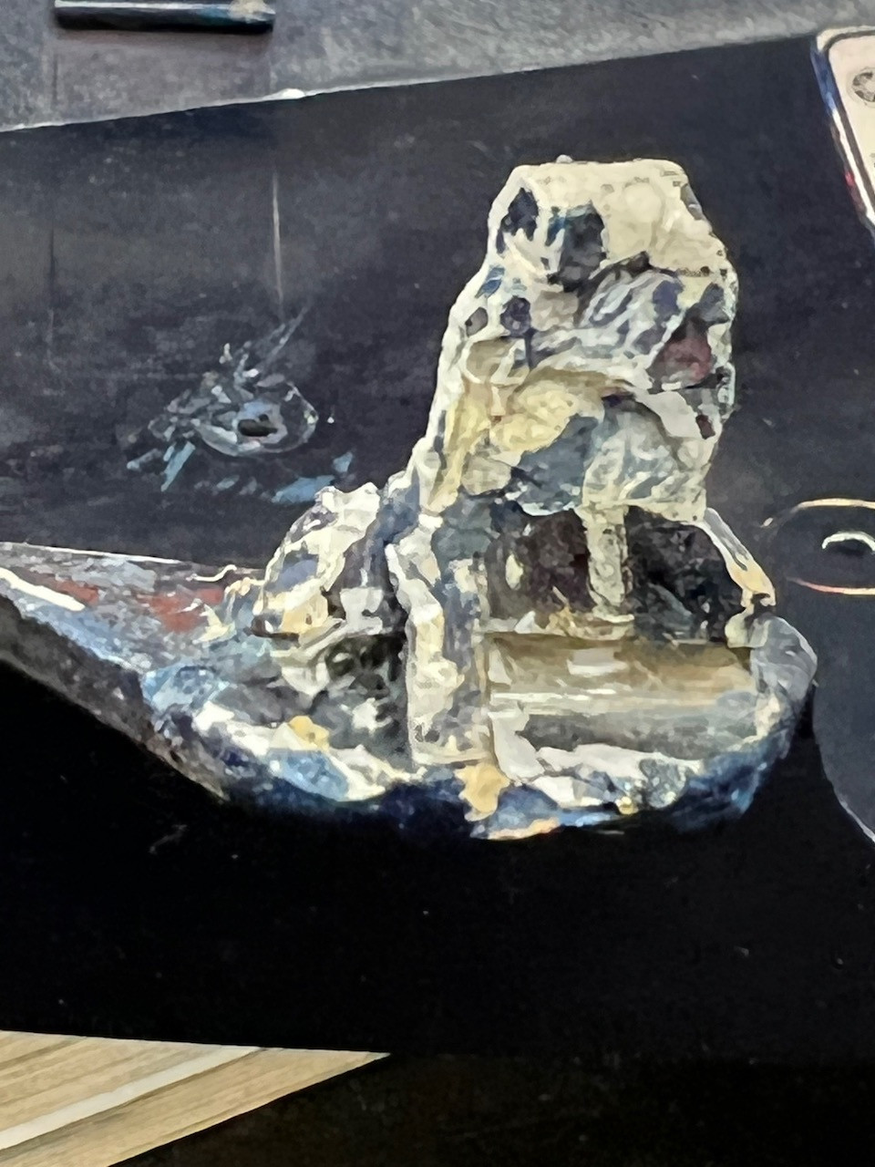

                  Thanks so much Guys!! I'll post what I come up with. I think I will fabricate the post/latch out of some sheet plastic, or maybe some T-Bar aluminum.
                  I've attached a couple of photos of what I'm starting with...
                  Sure appreciate your help!!
