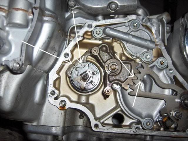

    Your problem sounds to me more like they gear isn't engaging fully at all since it goes from in gear to a false neutral. This could mean your shift drum isn't turning quite far enough for some reason. The easiest problem would be under your shifter cover where the actuating arm actually pushes/pulls the shift drum, You could have some bent/misaligned pins. Also, as you see in this picture, the two lines these arrows point at should be aligned if it's in 2nd gear.
    If everything looks good there, I would lean more towards you having a bent shifter fork. If someone before you was having the trouble you speak of, they may have been holding down the shifter with their foot to keep it from shifting out of gear and this can bend that shift fork, or wear on it enough so it can't push the gear far enough over to engage it fully.

            So I guess when one mentions or refers to a picture, one should probably post said picture, right? lol. Sorry...
            But that should be that those two lines on the left and the two dots on the right should all line up in 2nd gear. This one is showing the lines out of line.
