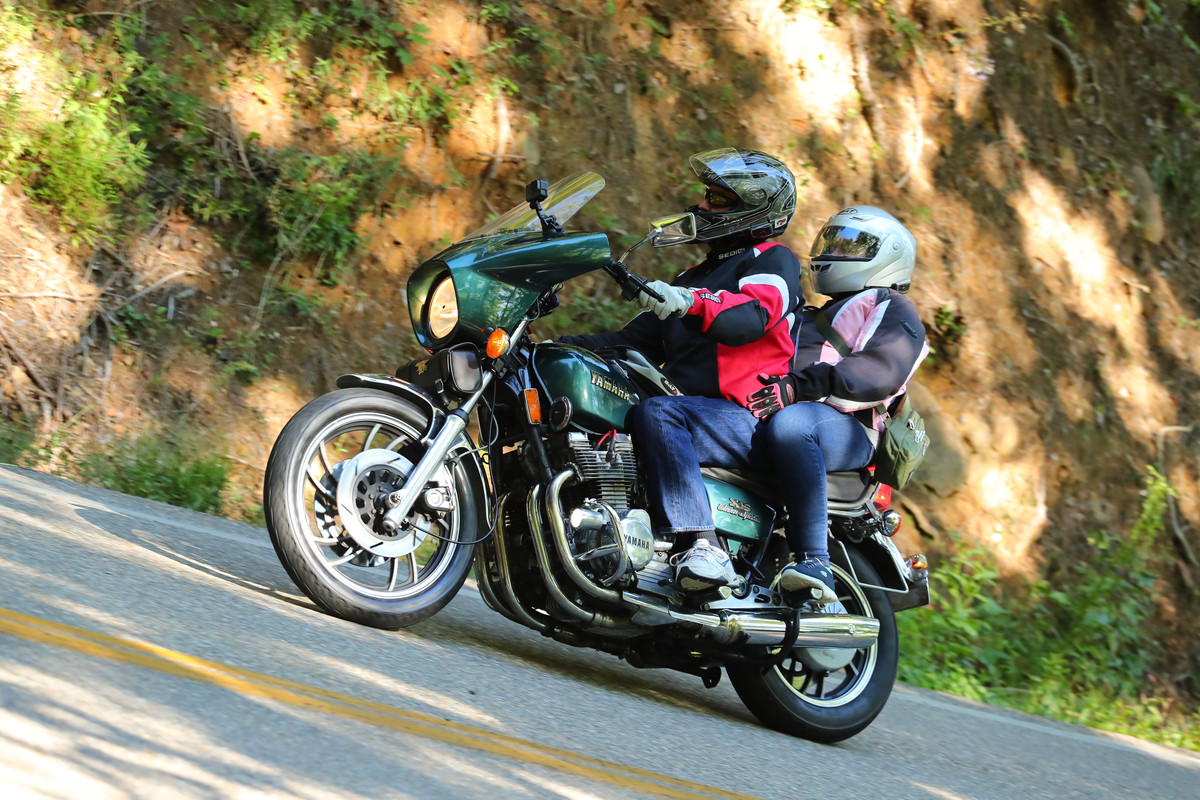

                        Thought an updated photo of "The Ugly Duckling" would be appropriate for this very old thread.
                        I drive this bike regularly and it remains my favorite..... These photos taken at the VINTAGE YAMAHA RALLY 2021.
                        Hard to believe I've had this bike more than eight years!!!!
                        Been a few minor changes including the Factory Sport Fairing but nothing really big. Bike starts and runs perfectly!

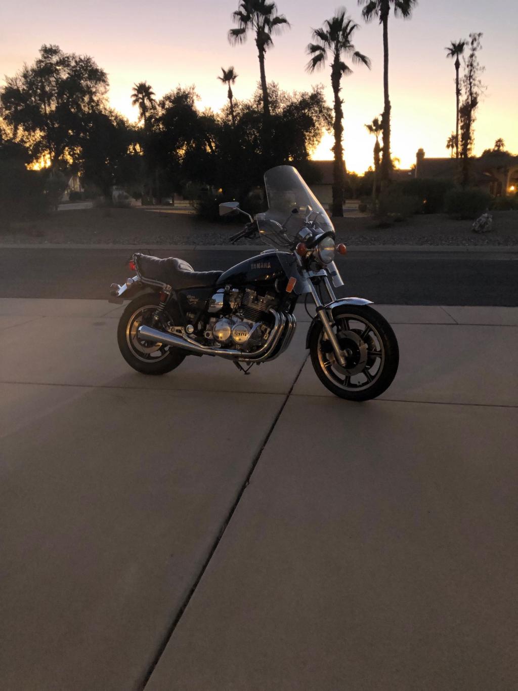

                                #255
                                Well, you've got your hands full, I'll grant you that.
                                Good to be young.
                                Myself, I've found it's worth the wait to find something that's belonged to someone who cared for that "pristine" bike. The amount of time required ( and money ) to get it into shape I no longer have.
                                I applaud your enthusiasm and look forward to seeing your progress.
                                As far as the wiring harness goes I think you should ask around for one from one of the members here. Just a thought.
