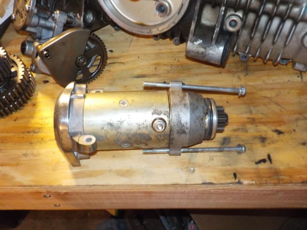

    Thank you this is a great tech tip. I have a few more Geese in the pen to quiet down.

      Thanks Tod & Ian,
      For showing and saving me asking
        Not a problem, guys. Glad to help when I can.

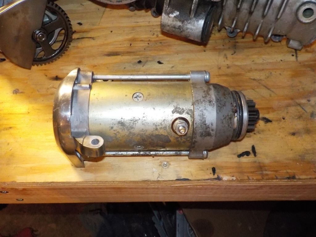

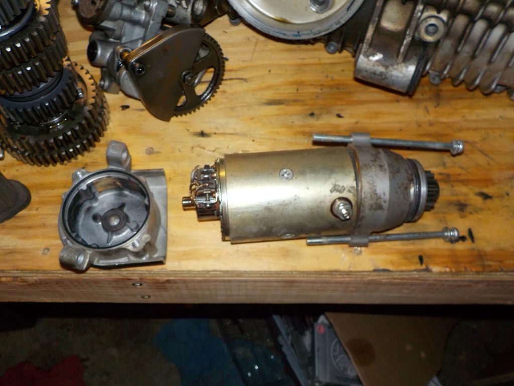

          Thank you again
          Ian thank you for asking and Tod thank you for posting the pix of how to do the squeal fix.
          I also cleaned up the copper commutator segments while I had it apart.
          The bike has never started so well. When the bike was hot it would struggle to start before no more! This fixed it.
          Thanks
