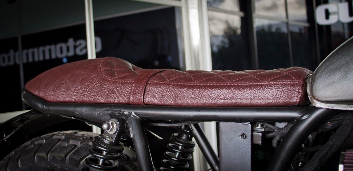

                You may wish to add a loop instead.

                    Absolutely! I was thinking about the cross brace being in the way. That's my hoop reasoning.
                    The stock bike has a fender, seat, and grab rail tying everything together. With that all gone, something needs to replace it. Note the loop on the custom done by professionals.
