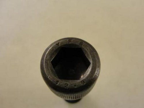

            Yep A2 are perfect for cover screws, I was trying to point out where high tensile are used on the bike A2's will not be strong enough.
            Another one to note, if using a stainless nut and bolt, like on the trees, use an A4 screw with A2 nut, this will stop galling happening, and antiseize.
            If you aren't sure about the high tensile applications, look at the screw head it will have 12.9 on it, or 8.8
