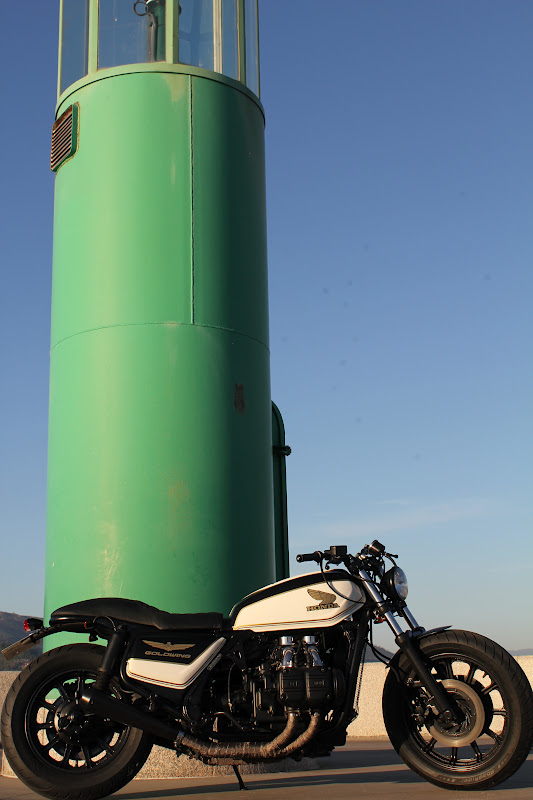

                Hey look! A GoldWing!

                        I few posts back, I was looking for this. Appropriate for a tire thread.
                        Gotta aim more for the eye, Marty.
