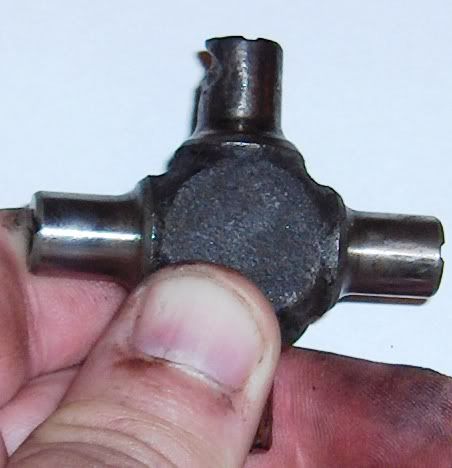

                  You say the body of the U-joint is Hollow, cross drilled?? Borrowed his picture:
                  Looking at it, what about drilling the CENTER Hub section, and fitting the zerk fitting there? If hollow, then you should be able to pack/squirt the grease throughout the hollow U-joint and have it make it's way to the 4 ends/bearing caps/zones?

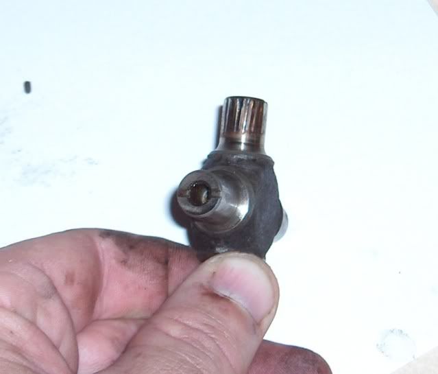

                    The two XS11 u-joint crosses that I've actually held in my hands aren't drilled all the way through end-to-end, there's just a drilled pocket to fool you and trap dirt, water or metal if you don't clean out all of the old grease.

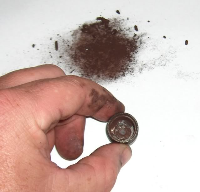

                        Had a similar incident with mine. The dust on the paper is all that was left of my needle bearings.

                          Thank's Tod! Your first picture shows the pocket in the u-joint cross!

                                Tod's picture's got the same cross in his hand as the two I've worked on, just a lot more ate up. You can see the bottom of the pocket in the cross, it's not drilled through. I though about drilling it through on one of mine, then I thought about there being plenty of perfectly good u-joints on eBay for ~$not-much-money -- shipped. That pretty well put a damper the drilling and the Zerk fitting mod too.
