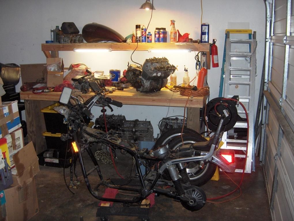

    Pulled the motor today on my most recent jigsaw puzzle.
    Most of the bike is in those boxes you see on the left. P.O. said it has the gear problem these 1100s have, so thought I'd split the cases and give everything a look. He had bought most of the stuff to make the bike fuel injected because he hated carbs, but he had the cheap Emgo filters on them and the vacuum advance was hooked up to the carb bell not the boot? I'm going to bring it back with carbs because I know absolutely squat about fuel injection.
    Tearing into it a bit, I drained the middle drive and saw massive chunks and shavings of metal stuck to the magnetic drain plug, so assuming the middle drive is junk and made me wonder if it has gear problems or the middle drive was the culprit? We'll see when I get to the gears.
    50k miles on the odometer and I see that someone else had split the cases before. Engine numbers match the frame at least. I'll probably try to contact P.O. and see if he knows why the cases were split. Gaps on all the shims were really tight and #1 had zero clearance, so I'm going to have to check to make sure the valve isn't burnt. Assuming it had never been shimmed since new. Several were at that point where the specs say .21-.25 gap and they were like a .16 or .17, so that one shim will put it back at the very bottom of the spec. so you aren't really sure to go slightly over spec or just put it back in at the bottom of the spec.
    I will also be pulling the head to be able to mic the cylinders and to plug off the YICS tube, but I quit for the day to go eat with the family for my birthday. I'm sure I'll have lots of questions when it comes to that elctrical stuff I suck so bad at.. lol. Everything has been disconnected and taken off, so all the magic smoke is gone...

      Have you ever found a worn shift drum on one of these engines?

        I like the multiple engines under the workbench.
        Are they all 11"s?
            No, not personally. I think the buttons on the shift forks are going to be the wear item, wouldn't they?
            @ RDMCguy... Yeah, those are motors for these 11's. I've got a few more than that, but those were just engines I've gotten without bikes. I was going through them at a pretty good pace at one time, but seem to have slowed down lately.
            The one at the far right, I just happened to catch a Craigslist ad when I was going down to Texas to pick up the Limie bike. It came from a bike shop with good compression numbers scrolled on an attached tag, but the guy never used it. $25 with chrome covers.. said it was going to junkyard if nobody claimed it. So...
            Middle motor came from Bob Jones' house. It was up on his engine stand and was about to get built for one of his project bikes when he passed away. I haven't gotten into it to check on the internals, but just making an assumption that Bob wouldn't have grabbed a worn out motor to work on with all the low mileage parts bikes he had around the place. I'll give it a look-over one of these days.
            Motor on the left is apart, but it has the cylinders and pistons from a low-mileage motor that came from a guy that wanted his bored and Wiseco pistons installed. Talked him into getting another set jugs to bore and leaving these good stock ones intact.
            We won't discuss the other motors in parts bikes or all the extra parts from other motors.. You may be able to catch me in a future adddition of Hoarders.

              Not saying you're NOT a lazy bum.. lol.. but the bike came home with me looking like this already. As I said, most of the bike is in the boxes you see here on the trailer.

                  Happy Birthday Tod! I was thinking, that must be a good-sized bench you have, as that 11 engine looks small sitting on it. Shoot, my 750/850 engines are small next to the 1100, and they are not easy to lug around. I cannot imagine pulling my 11.
                        I ripped a piece of plywood, so the main bench is 8' x3' and used the 1' piece for a top shelf. I made the base from old treated guardrail posts I got for free from work. The part that was buried in the ground is still good, so I just pressure washed them and good to go. It worked out pretty well, so after I clean up the garage a bit, I'm going to add another 8' section along that wall and match that along the opposite wall. Wife wants to be able to park a car in a 2-car garage... can you imagine the nerve? She's sure cutting into my motorcycle space. But.. she's already told me to build a shop, so I'll have some more room to buy more motorcycles..
