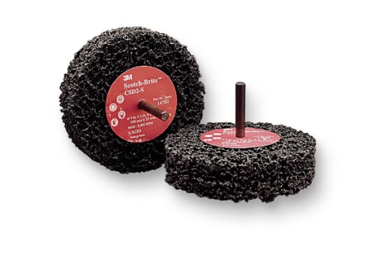

          They have the Scotch Brite discs at wallyworld, let's see if this photo link from 3M works?

              TC the ones pictured in your reply are far to rough to be using for gasket removal. I have used them and they will tear out 3/4 inch of Bondo in a few seconds.
              I use the earlier mentioned ones that appear as a scotch bright pad. They are great but require a compressor to do the job, which many do not have.
              The CRC stuff that Ol Red mentions works very well to get gaskets off. It is fast and serious stuff for getting a gasket to almost dissolve before your eyes. Big down side to it is it will harm aluminum if left to long so be wary of that. If it is rinsed off quick enough it may not be a concern but it does take more time to get the more seriously stuck gaskets off as well.
              The razor blade scraper is ones best friend if you do not have a compressor handy. Heat will aid it. If one does have a compressor then you can not beat the 3M scotch bright looking pads. I have some here but they appear to not have a part number I can find. I can take pics later if it helps.

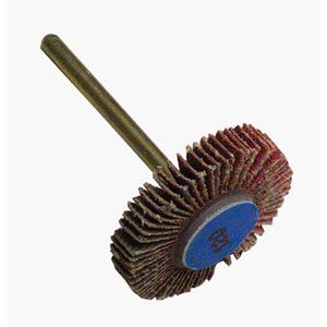

                I usually scrape the easy stuff with a razorblade knife and finish with a little flap wheel sander that Dremmel makes. Small enough to get into those tight areas between studs.
