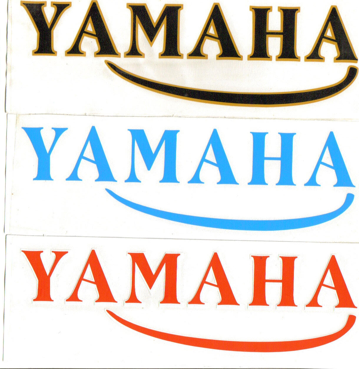

      YAMAHA decals
      I would have expected Fred to know where to get these. He probably does.
      650 Central has these in various colors. Click graphics on the left side of the page. They mimic Triumph.
      Omar's has several styles including Velocette style.
      I have seen a Norton graphic as well, but I can't find it at the moment.

        Originally posted by Garagamus
        The British style Yama logos are actually freehand painted. I had one guy while getting a coffee, actually turn around in traffic and come back to the parking lot thinking it was a vintage norton he had stumbled upon. I'm going to try and put together an actual decal before spring. I recently left oil field work to try my hand at a bodyshop/collision centre, tons of toys to mess around with and a legit paint booth. Learning the body trade is a slow go at 43, but my title there is a 3M paint protection and graphics installer. I figure if I've got access to a state of the art plotter and a boatload of vinyl, I should be able to come up with some pretty cool decals. Still on the fence regarding the shocks. I'll probably end up taking them off your hands, (once I've paid for all the air tools for the new job).
        Hi Garagamus,
        like those previous posts say, I can get Triumph-styled or Velocette styled decals from the USA but I was hoping for a Canadian source.
        Good luck with the new career, note that it's easy to go broke buying air tools
        and don't go near a paint booth without wearing all the protective gear.
        The shocks can sit on the shelf, no problem.

          Hey Fred, as soon as I've put together some proper patterns, I'll post what I'm capable of supplying. The only guy from ebay that seems to have the Norton/yam logo is out of Greece and the shipping just isn't worth it.
