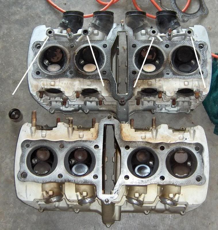

            The bigger valves in the later heads required a larger space, or pocket in the heads, (Valve relief) thus reducing the compression ratio. Yamaha tried to compensate by doming the pistons considerably higher in 80' and up than the 78/79 models. Here's a 78/79 piston on the right next to one of the later models on the left.

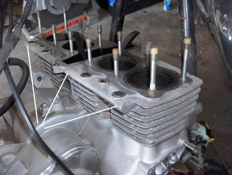

            If you're taking the head off to swap with an early head just for the sake of convenience thinking the YICS ports needing blocked is too much a pain, if you add the early head, you'll still have to block the YICS ports on the cylinder. On the XJ, there's a tube attached to the back of the cylinders with 4 ports that match up to 4 ports in the head. Here's a set of cylinders off an XJ.
            And here's a picture of an XJ head, with arrows pointing to the ports in the head, with an early model head at the bottom for comparison.
            If you use the XJ head on the XJ cylinders, just plugging either the cylinder ports or the head's ports will fix it. If you want to install an earlier head on the XJ cylinders, you'll still need to block of the ports in the cylinders since they'll be exposed to air and your carbs will be lean and your motor will be sucking unfiltered air.

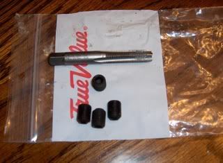

            As others have said, you can permanently install a YICS tool in there, but you're dependent on rubber O-rings staying sealed and I don't know how well that would do in the long run with all that heat. I just tap them and install these allen plugs with some teflon tape around them. It's permanent, but I guess I could always pull them out if I ever changed my mind for some reason.

              I don't see why the YICS ports in the jugs would need to be blocked if an XS head is used, they are hooked into nothing but themselves. The only thing blocking them would do is keep dirt out of that tube.
                You are correct and it was late last night. The only thing you'd want to plug them for is because they would be exposed and water and crud would get in there.
