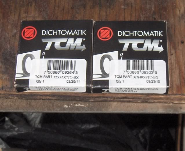

        If in fact it is the crank seal, (More likely than the galley plug) then the rotor can be a pain to get off. You'll need a pulley puller or a bolt to fit the inside of the rotor (I forget the size, but a 1.25mm thread.. oddball). If buying seals, I suggest a good double lipped seal such as these.
        Most are just a single lip of rubber riding on the crank. These have two.

                  I remember looking at a parts list once, and I seem to remember the '78 having those seals swapped. One is larger, one is smaller, and if you only ordered one... I'd make sure you have the right one. I've slept since then, but I think you need the smaller 45mm one for that right side. Also, if you bought an OEM seal, and it has the lip on it, you'll have to split the cases to install it.
