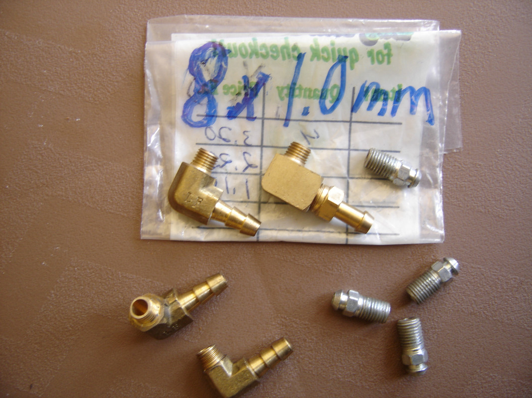

                  To check the fuel levels I made these out of Metric grease fittings (silver) and brass ells that I ran a metric die over and cut 8 x 1.0 mm threads which is what the float bowls are. I drilled the grease fittings out on the drill press but the brass ells are less fuss and the hoses stay on better. I use o-rings on them to seal and it helps to clock them properly.

                    I think I like the brass idea!
                    From the picture it looks like they ran out of barbed ells in the bin and you had to scavenge up a separate '90 and a nipple.
                      • 2101
                      Thanxs, and yep you nailed it, almost. I had to run back down to Busy Beaver, what we have for a local lumber/hardware/ and everything else, to fetch another 'cause I F@#$%& up the fourth ell.
                      I was tired of the hoses fallin' off of the brake bleeders.
                        Ouch...
                        Yep, I hate when I'm running the engine for the dynamic fuel heights, drop and recovery levels, then a hose pops off one of the bleeder screws and fuel goes everywhere.
