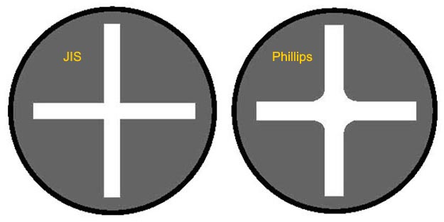

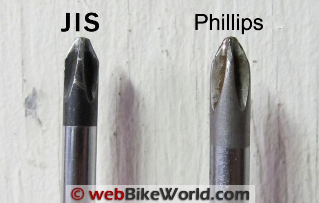

                      I believe those screws come out with a JIS (Japanese Industrial Standard) screwdriver. If you use one you should be able to back the screws out, staked or not.

                        Anybody who thinks JIS screwdrivers a myth like the Unicorn, I'm here to tell you they are money well spent, less stripped carb screws, with the JIS screwdrivers I haven't had to use my impact screwdriver hardly at all. These are the ones I bought---> http://www.ebay.com/itm/Vessel-Japan...item20cf0e0442
                        There are a few other brands and sets, but these are the best for the money, and careful at some of them on eBay, they make the pictures look larger than actual size.

                              I think the difference in screwdriver tips can be how they're made and by who. Some are formed by squeezing them to shape which generally results in a stronger tip but less precise shape. Some are machined, which gives you sharper, more precise flutes but will break easier if inferior materials and/or heat treating is used. The driver I use is a NOS/NLA Proto 'machined type' which has held up extremely well to use. There are variations in tip shape (even for the 'same' size) between manufacturers (my Proto is marked #2 Phillips, but looks more like a JIS), so don't just depend on the given size but look for fit...
