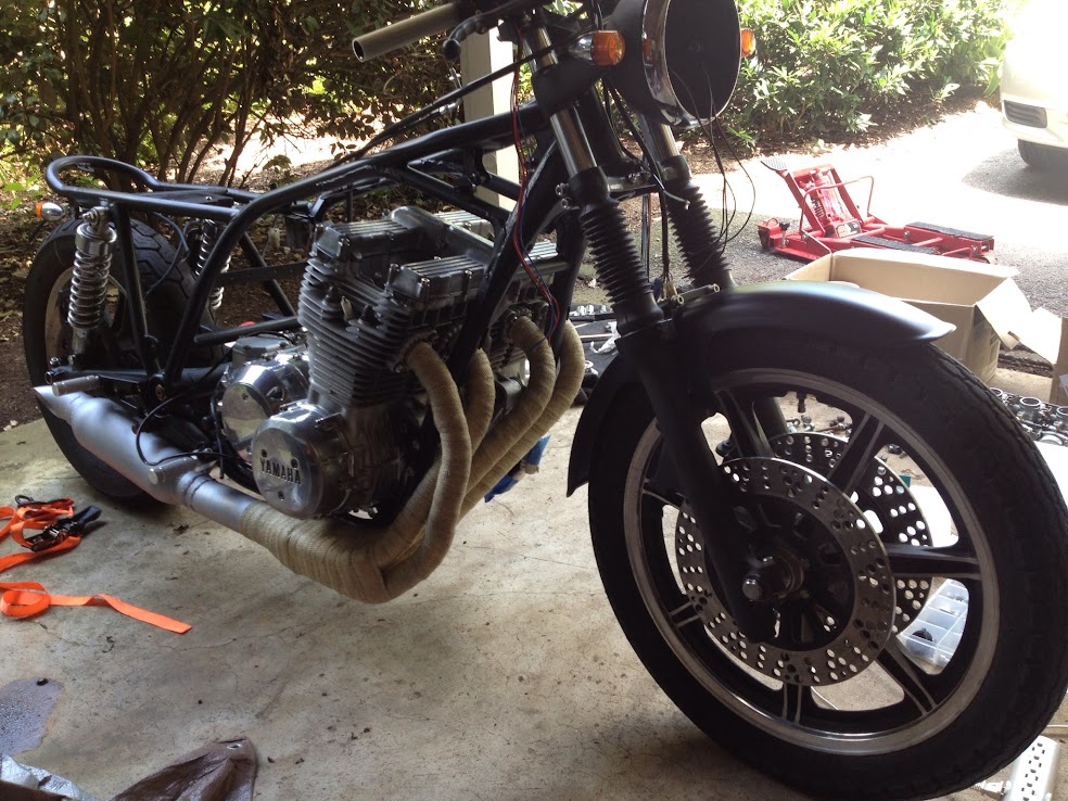

                  Here is a pick with the exhaust on the bike:

                    Looking good!! You are doing some wonderful work to your bike! Wish I had the time and tools to do similar to mine! I'm just a hack with a grinder and a welder!!

                        before you committ to that exhaust you might want to check it for ground clearance when the bike will be leaning to the right...I had a Jardine 4to 1 exhaust and it dragged on even the slightest lean...and your setup looks pretty much like it would do the same...
