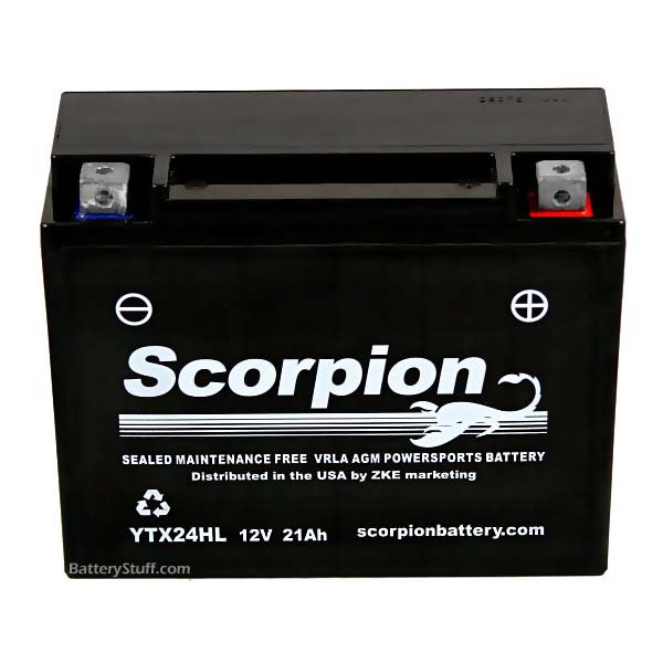

                          After reading this thread, I did a quick search to refresh my failing memory about what an AGM battery was, etc., and found this site offering AGM batteries, and they provide FREE SHIPPING for motorcycle batteries....check out this product for the XS1100 series replacing the Y50-N18 Walmart style!
                          Check out the PRICE!!
                          The Scorpion YTX24HL-BS battery is a high-performance, sealed AGM motorcycle battery. The YTX24HL BS features 350 CCA and a 1-Year replacement warranty!
                          I looked on Walmart.com, only found 1 reference for "non-spillable" lead acid battery which is one of the many terms used for AGM type batteries, but they only said "found in store", and was an AUTO sized battery....called their Everstart "PLUS" series?
                          HTH?
                          T.C.
                          PS, here's their INFO about types of batteries for your review:
                          Wet Cell (flooded), Gel Cell, and Absorbed Glass Mat (AGM) are various versions of the lead acid battery. The Wet cell comes in two styles; Serviceable and Maintenance free. Both are filled with electrolyte and are basicly the same. I prefer one that I can add water to and check the specific gravity of the electrolyte with a hydrometer. The Gel Cell and the AGM batteries are specialty batteries that typically cost twice as much as a premium wet cell. However they store very well and do not tend to sulfate or degrade as easily as wet cell. There is little chance of a hydrogen gas explosion or corrosion when using these batteries; these are the safest lead acid batteries you can use. Gel Cell and some AGM batteries may require a special charging rate. If you want the best,most versatile type, consideration should be given to the AGM battery for applications such as Marine, RV, Solar, Audio, Power Sports and Stand-By Power just to name a few. If you don't use or operate your equipment daily, AGM batteries will hold their charge better that other types. If you must depend on top-notch battery performance, spend the extra money. Gel Cell batteries still are being sold but AGM batteries are replacing them in most applications. There is a some common confusion regarding AGM batteries because different manufactures call them by different names; some of the more common names are "sealed regulated valve", "dry cell", "non spillable", and "Valve Regulated Lead Acid" batteries. In most cases AGM batteries will give greater life span and greater cycle life than a wet cell battery.
                          AGM: The Absorbed Glass Matt construction allows the electrolyte to be suspended in close proximity with the plates active material. In theory, this enhances both the discharge and recharge efficiency. Common manufacturer applications include high performance engine starting, power sports, deep cycle, solar and storage battery. The larger AGM batteries we sell are typically good deep cycle batteries and they deliver their best life performance if recharged before allowed to drop below the 50% discharge rate. The Scorpion motorcycle batteries we carry are a nice upgrade from your stock flooded battery, and the Odyssey branded batteries are fantastic for holding their static charge over long periods of non use. When Deep Cycle AGM batteries are discharged to a rate of no less than 60% the cycle life will be 300 plus cycles.

                              thaks for all of the helpful info cleaned all connectors like new including grounds. tested battery said it had a bad cell and was no good i ordered the one above hopefully that puts an end to my problems
