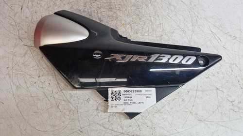

      It depends what you mean by "expensive" re shipping. The bit you're after doesn't weigh much at all... I took mine off the other day to mess around. It would travel ex-UK at small packet rate. I can get one for you and send it to you if you want!
      http://www.ebay.co.uk/sch/i.html?_od...iring&_sacat=0
      I bet the XJR side panels could be made to fit too.....

                With some messing about, I reckon it would be possible to use XJR seat/tail, side panels and airbox......possibly.........

                    That's my bike, and to get the tail and seat to fit you will need the rear subframe aswell, which is welded onto the XS rear rails, which were shortened.

                            Jeez, you don't want much do you? I'm not taking the tail plastic off, too much mither.
                            First picture is the welded on XJR subframe. It's got a strip of metal on each side at the front section, and one on each side at the rear, to give the right height for the seat so that it's like the XJR.
                            The second picture is the cut off XS frame rails, which are plugged to stop water getting in.
                            You'll need the XJR grab rail unless you fill the tailpiece where it goes.
                            The tail light i couldn't get to work using standard XJR/FJ bulbs, don't know why, so i fitted LED's into the XJR lens.
                            That's it.
