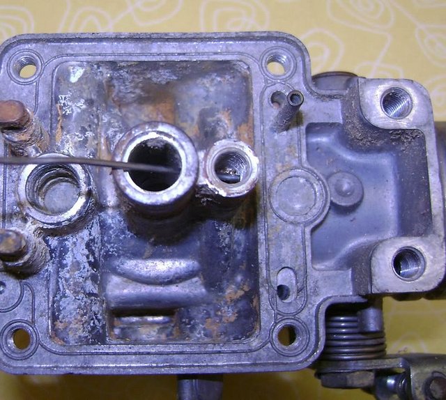

            Thread revival!!! Haven’t been on here in a long time because I sadly sold my XS11, but I just got my hands into another (buddy bought it and came to me to get it tuned up right) and it’s a 78, (mine was an 80) and I jumped right into the carbs, thinking it had stock jets (with pods and spaghetti pipes, no baffles) it was exhibiting lean symptoms (pipes are dark blue and hesitated badly upon giving it throttle) but when I opened the carbs up I found 145 mains and 45 pilots, should be ideal jetting for this setup. But what’s stranger, to me, is the caps over the pilots, so they have to feed thru the main channel, I don’t recall my 80 having plugs over the pilot pickup, and nothing else I’ve taken apart to date has such a setup. Theoretically opening that up should allow fuel to flow more freely, correct? Would that solve this leaning issue? Or should I reinstall the plugs over the pilots and fiddle with the air screw and needle positions instead? Thanks for the help!
            BARE BONES CHOPPERS: If it don't make it go faster, you don't need it!
            80 XS1100SG(cafe in progress *slowly)
              • 8963
              The 78-79 use different carbs than the 80-81. There should be a screw covering the pilot jet tower. Those jet sizes seem fine, probably just need a good cleaning. BTW be careful not to break the tips off the idle mixture screws by overtightening. May want to check them to see if the tip(s) is broken off and stuck in the carb body, this for sure will cause a low RPM lean issue.
                • 8963
                A general rule, if there is a drilled passage between the main and pilot jet towers, you will need a plug covering the pilot jet tower. No passage, no plug required.
