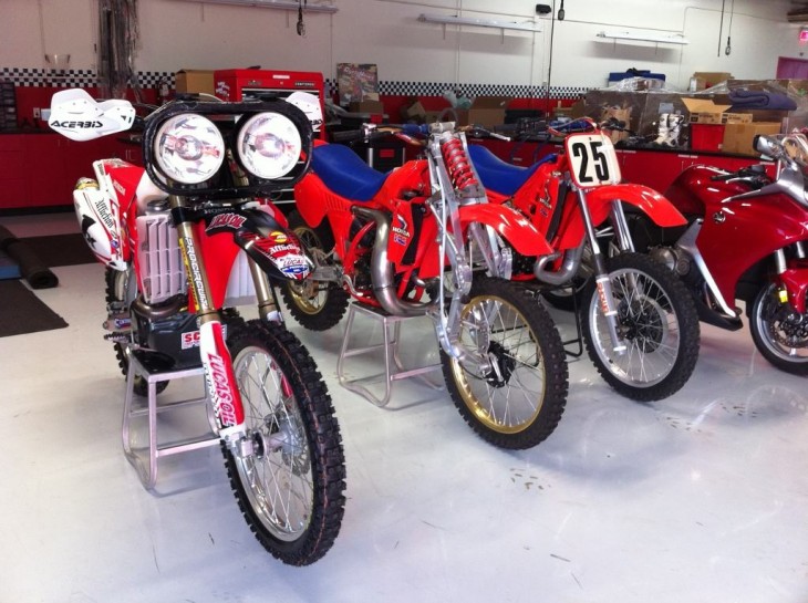

                            your design looks a little like this...
                            The second bike shown in closeup looks a bit similar except the spring/shock is located in a different place.

                              front end.
                              whooaa.. looks like a bit more challenging to figure out pivot points and strength points.. actually looks much weaker than my MASSIVE setup but obviously they got it to work well. And being that its a dirt bike im sure it gets a ton of abuse.
                              Thanks for sharring that.. now i feel much better about my setup..

                                Originally posted by roccet
                                whooaa.. looks like a bit more challenging to figure out pivot points and strength points.. actually looks much weaker than my MASSIVE setup but obviously they got it to work well. And being that its a dirt bike im sure it gets a ton of abuse. - - -
                                Hi roccet,
                                yeah, complicated little thing, ain't it?
                                As to it's strength, even if offroad riding stresses are more than you see on the road, it's carrying mebbe 30% of what an XS11 weighs.
                                And, while your main girders look like they came off the Forth bridge, his suspension link is a U-shape while yours are single arms which puts all the flex resistance onto the wheel axle.
                                And your design is still a trailing link.
                                Trailing links suck.
