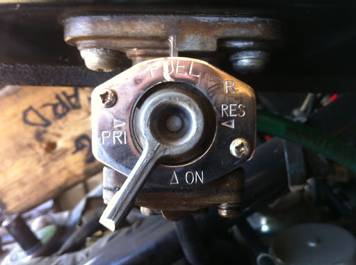

        So, here is a picture of the petcocks on my bike. You'll notice a small scuff on the word "FUEL" which happened when I was doing the dremel mod to create an "OFF" position.
        This next photo is the tube I was talking about, it comes off the right side of the petcock, and was melted shut. Any ideas as to what this is doing?

                The melted tube
                Is the vacuum tube that should be hooked to a vacuum source (like the nipples on the manifold to carb boots - you can hook to these because this vacuum is not open and will not affect the running like an open vacuum leak would.
                Without that tube going to vacuum, you standard petcocks will not auto shut off - they might not have been doing that anyway or the prior owner didn't know what that nipple was for so he just blocked it off.

                  Without that tube being connected to a vacuum nipple, your fuel diaphragm willnot open, which means it should only flow fuel in the prime position. If it flows in either on or reserve, something has been altered inside, which can cause you all kinds of grief.

                    sorry - ken is right - i am backwards
                    with the vacuum - which only makes sense if you think about it -
                    how can you have vacuum without the engine running?

                      So is the tank a special teardrop tank or the standard kinda square tank with the knee indents? Those are certainly standard petcocks which it seems have been modified to flow all the time, and those have likely been plugged because the diaphragm is leaking and if those are taken off gas comes out of them . I've seen them do that before. You could probably fix those and have the vacuum function back, or just leave them alone and remember to shut them off when the turn off the bike, your choice. The kits can be had from georgefix on ebay, just make sure to get STANDARD petcock kits, not specials, cause their not the same. Then again there is a tech tip in the tech tips section on how to solder up one of the grooves in the back of the handle of the petcock and end up with a modified petcock that is no longer a vacuum unit and then you don't have to bother, and then prime would be off, on would be on, res would be reserve, and the extra off would be another off .

                          It is the squared standard style tank. I haven't messed around with the petcocks too much. In the past I always pumped out the gas before pulling it of for any work. I need to put it on the bench, put a bucket underneath it and figure it out for sure. The previous owner had the entire bike rebuilt by a custom in Kansas long before I got it, so there are little things like this all over the bike. Without this forum I would've had put the poor thing down long ago.
