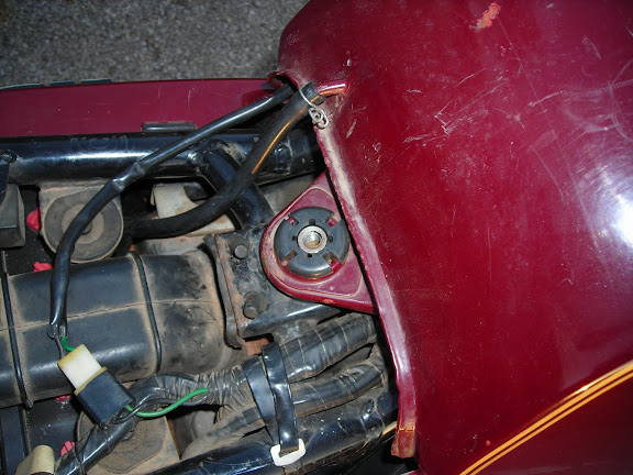

    I realized I have no bolt holding the rear of my tank down. If anyone knows what size or hardware aside from just a bolt please tell me while I've got this taken apart so I can get whatever I need.

      Pretty sure it's M8-1.25-20 (size, pitch, length). You'll need a washer too.

        It's an 8mm bolt with a 1.25mm thread pitch. I don't remember the length but it's about 13 to 15mm long.

              PO had the bolt it turns out. I found it after seeing the size you put and thinking "hey, I think I saw that with some other things PO left me." No washer, but I had one that fit.
