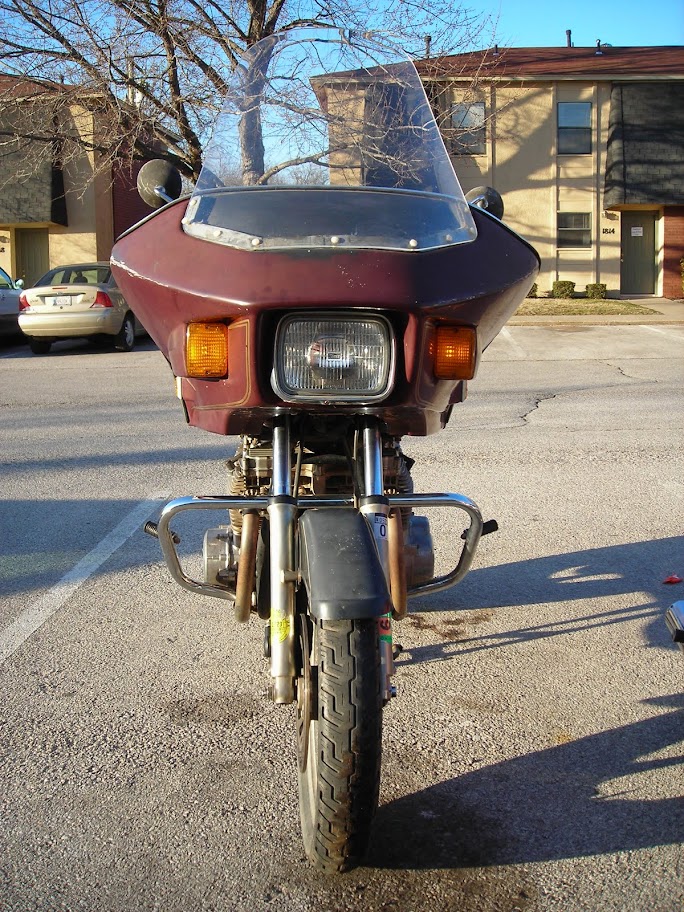

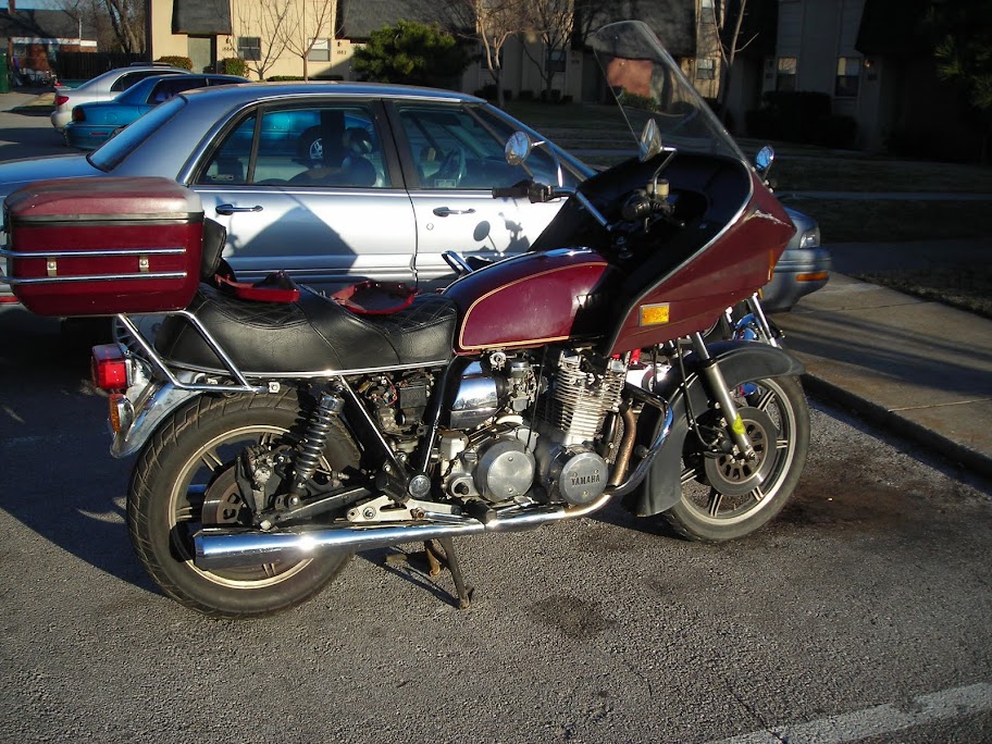

                      So, I finally got my camera out by my bike and took way too many pictures. Oh, and more good news. All those disconnected wires, two of them were somehow connected to the blinking thing, so that's all working now. And it turns out there were at least 15 loose wires (I stopped counting once I realized one of them just made the blinker blink).
                      Now, to the pictures:
                      Missing from these pics are the matching saddle bags. They were detached when I got the bike, and are a wee bit filthy. PO said something about the latches being broken, but I'm unsure if he was referring to part of the attaching mechanisms or the lid latches as they looked ok. I'll worry about those later.
                      Now, I believe this bike has seen a lot of sun due to the discoloring on the fairing. I think it is an original fairing that came with the bike, but you guys are the experts, not me. You can also see that the trunk has been well used. Curious about that other bike? Check the other bikes forum for an upcoming post.
                      I'm not sure if the bike has ever been laid down, but there that nice mark along the fairing. Not sure how I feel about the highway pegs, but I haven't ridden more than 2 miles without needing to shift yet.
                      Did I mention, I finally got it up on the center stand! The first time I had to grab both sides of the seat. This time was easier.

                      Personally, I think the fairing is kind of ugly. Is it hard to take off? It looks real complicated to me the noob. I have enjoyed the windshield though. Now the tire well (I don't know what else to call it, tire guard?) is an aftermarket ugly thing. As best I can tell, my forks are stock, but I don't have the brace thingy.
                      If y'all see something that looks wrong in any of these, please tell me.

                      Pretty sure those are the original pipes too.
                      Yeah, that trunk has a lot of sun rot on the top .
                      Not sure what the stock seat feels like, but this one sure is comfortable.
                      I find the purposefully dented pipes amusing.

                        Hi Drake...Welcome to the site...I am almost certain that fairing was not from the factory. In '78 they just didnt come with them...some previous owner put it on. On the whole the bike looks pretty good. There looks to be a fair bit of rust..particularly on the gas tank filler area...you might have more in the tank itself...there are threads dealing with how to remove the rust.No doubt you'll have to clean the carbs too...check the tech tips as well... If this is your 1st big bike...be aware that these are big and heavy machines. In their day they were the fastest production bikes on the market. Even today an XS in good tune can still run with 90% of todays bikes. If you have no real riding experiences aside from 50cc machine I suggest you invest in a Motorcycle safety foundation BRC (beginners riding course) and a good helmet and jacket. You have found the best site dedicated to keeping these bikes alive and well. Best of luck and dont be afraid to ask questions if you cant find what you need to know....BTW those rubber intake boots on the carbs look bad...if the right side was replaced then i would do the left side as well

                          ....I think it is an original fairing that came with the bike, but you guys are the experts, not me.
                          That's the 'factory' Pacifico fairing, but these were either dealer or owner installed at the time. Yours looks like it was added later due to different fading.

                          ....Personally, I think the fairing is kind of ugly. Is it hard to take off? It looks real complicated to me the noob. I have enjoyed the windshield though. Now the tire well (I don't know what else to call it, tire guard?) is an aftermarket ugly thing. As best I can tell, my forks are stock, but I don't have the brace thingy.
                          It's not all that hard to remove, but you'll need a headlight bucket, mounting ears for same, front turn signals w/mounts, and maybe some wiring harness bits. All this stuff was removed for the fairing, so unless you got these as 'spare parts', you'll need to pick these up. Yeah, that front fender is pretty ugly, so I'd ditch that too. These are all over Ebay or contact Andreas. Make sure you get one for a 'standard', as the special fenders won't fit. Your forks are stock. In fact, the whole bike looks pretty unmolested and in very decent shape all-in-all.

                          ...Pretty sure those are the original pipes too.
                          Yep, they are. Not in that bad shape either it looks like.
