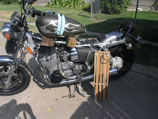

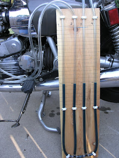

                        Just thought I would post a picture of my home made gauge. It worked well and only took a short time to sync. The hardest part was getting the two pairs to sync after I had sunc (sp?) 1 to 2 and 4 to 3.
                        I don't know if they are better or worse than the gauge type, but they are cheaper and really I was just looking for a place to post my handiwork.
                        Here it is running after I synced (sp?) 1 and 2.

                          En-Gauged!
                          I Like it.
                          Something tells me that I wouldn't be able to find a label with the words:
                          "Heche en Mexico"
                          "Product of China"
                          Looks like you used a totally closed loop/system instead of a separate vent tube. A separate vent tube might make the fluid response more sensitive and lead to a "closer" synch between the carbs. It also might allow the fluid to get sucked into the engine.
                          Be sure to put "Made In The USA" on it somewhere.
                            Que es un (what is a) separate vent tube?
                              A survey in Texas found that 29% thought that there was an imigration problem. 71% responded "No es un problema."
                              ?lo siento pero que es 'vent tube'? !no entiende!
