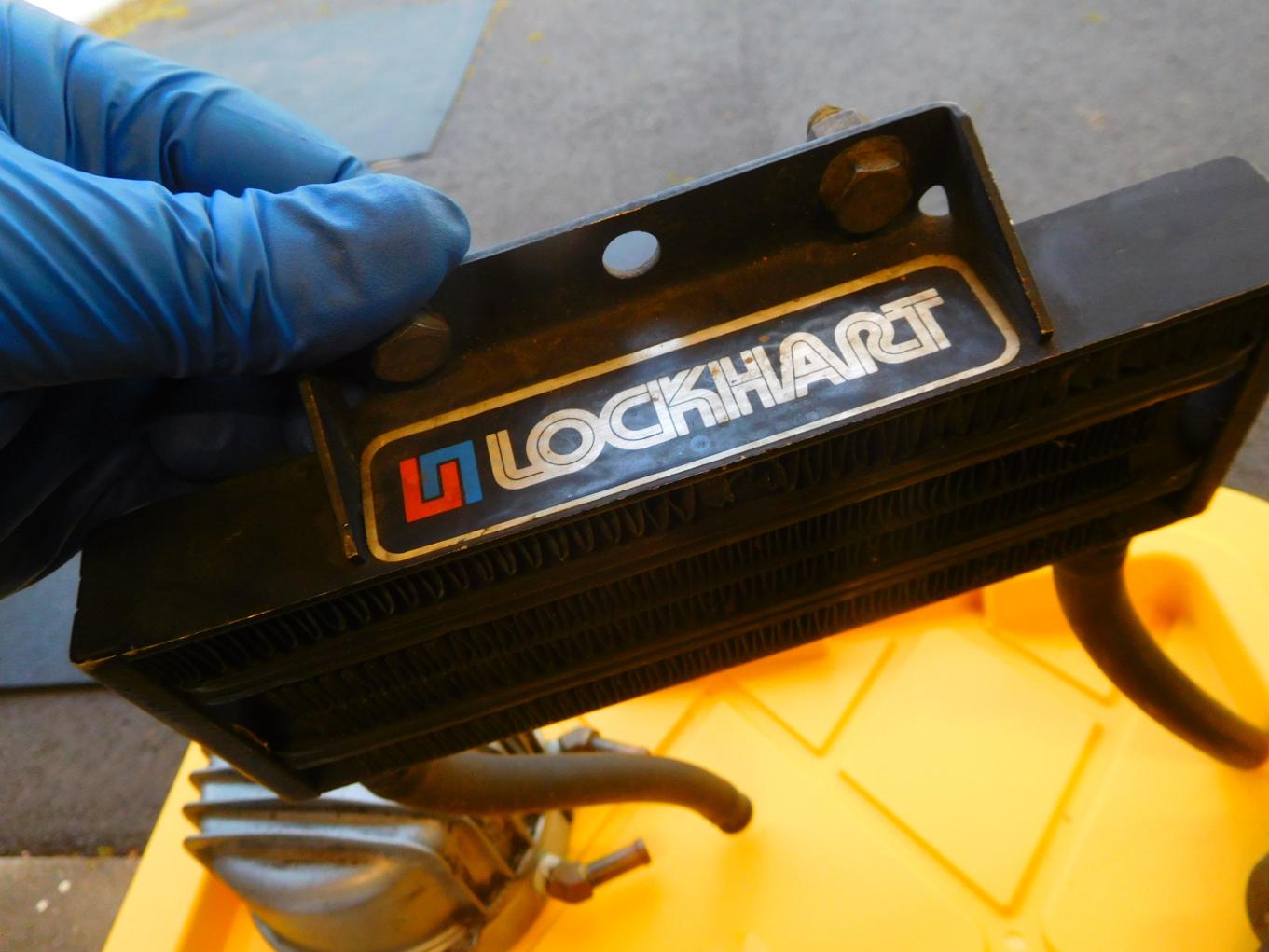

          I guess I should have clarified. The adapter that is mounted to my bike does not have barbed fittings or if it did when it was installed it on longer has them. The previous owner swapped them out for these Harley Davidson style stubby fittings which are so short it's very difficult to get enough hose on the shaft to properly clamp it down. I don't use the standard worm drive hose clamps because they dig into the hose when tightened. I use high pressure fuel injector clamps that don't deform the hose when tightened. However these fittings leak terribly when the thermostat opens to allow oil to circulate through the cooler under pressure. This is a two piece unit with a separate thermostatic bypass valve and radiator like the ones used on the '79 Sportsters and FX models (See photo) the brand name escapes me at the moment but it is a very cumbersome system with multiple connection points which in turn welcomes multiple failure points. None of the hose fittings are barbed which makes it extremely challenging to fit the hose on tight enough without deforming. My question is would I be able to remove the wafer adapter completely without having to modify the oil filter housing ? These bikes are notoriously cold blooded anyway and mine rarely gets above 80 Celsius unless I'm stuck in traffic on a hot day, so I'd rather just remove the problem all together if it doesn't involve any major modifications. Thanks
            The brand name is Lockhart. I pulled the oil cooler off of mine as well. It's not needed unless you live in Arizona. You just need a new O-ring and remove the adapter bolt.

                        Yep that's the one. Okay cool it's gone as of tomorrow. I always keep an extra filter and O ring handy, so this should be an easy fix. Thanks so much !
