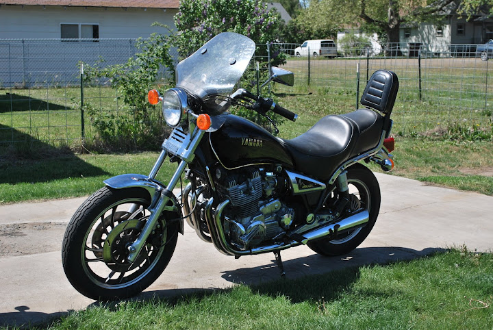

    BTW, here's the pic of my new baby.

              I also wanted to say welcome to the forum!!! Us XJ guys gotta stick together!!! LOL Nice lookin' wheels.
