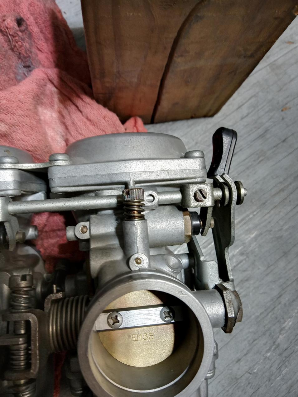

              Guys. Where do i put the ball im lost. 1979 xs special
                The balls and springs go in the number 1 and number 4 carbs so that the choke lever detents catch on them. On most unmolested carbs there is no place for them on 2 and 3, although many drill a spot for them when swapping carb bodies around.

                  I think this is why my choke idle is almost at 2-3k range. Thanks do i need to open up the carb or is the entry hole on the outside of the carb? sample pictures if possible? or a number on the diagram? cajun31
                    The spring and ball go in the small hole to the right of the idle mixture screw in the picture below.
                    The choke rod must be removed first obviously. Click image for larger version  Name:	IMG_20220416_180007.jpg Views:	0 Size:	149.0 KB ID:	868376

                      bikerphil to the rescue! Thank you brother! Did you vapor blast those carbs? Looks very clean.
                        Yep, I think they were, I bought them like that. Unfortunately the guy who rebuilt them f'd them all up. They look nice but that's about it.
