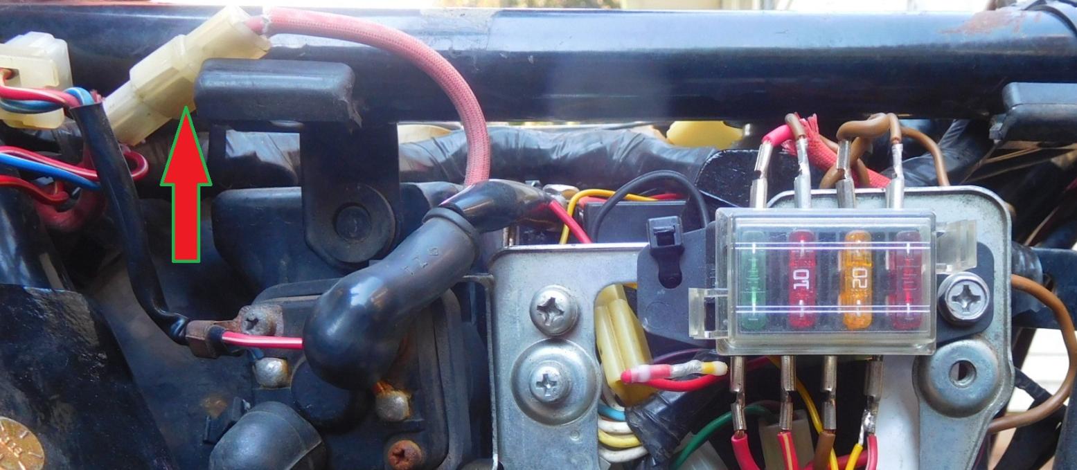

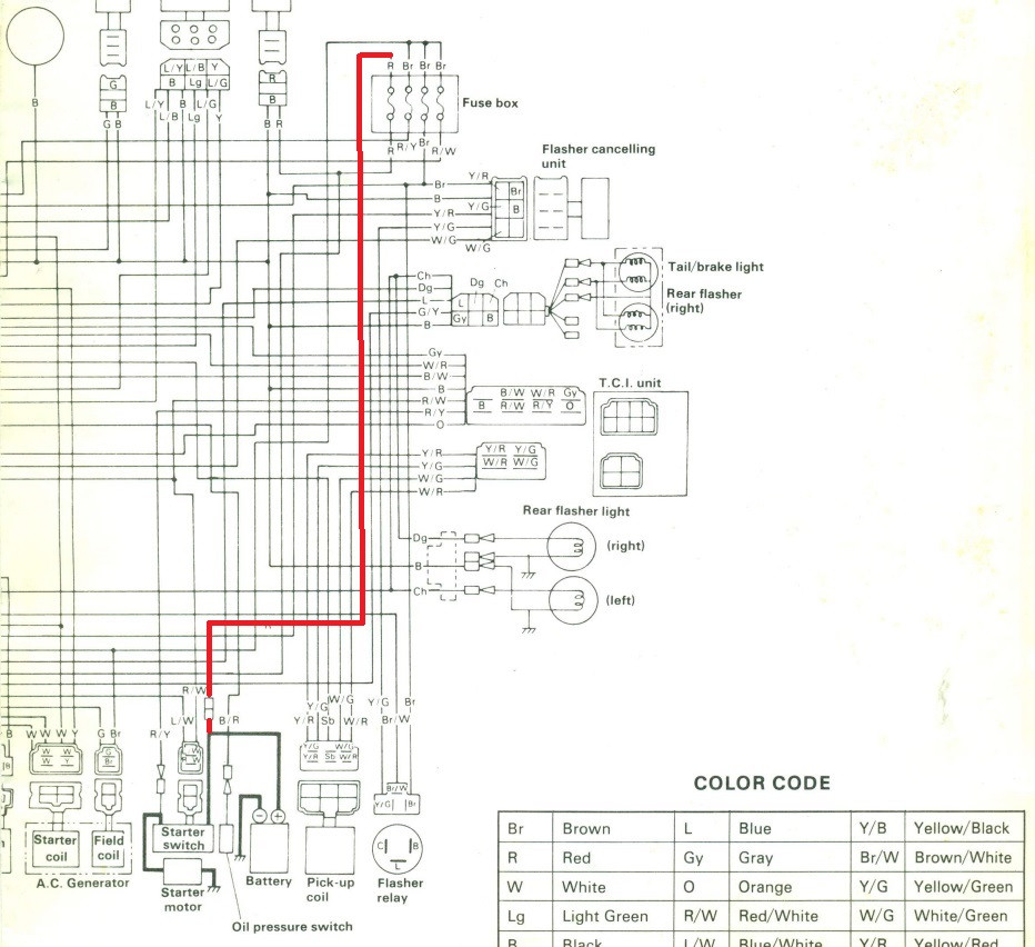

    According to what you described and the schematic that Ray provided, the red wire has a connecter on the end that connects to another red wire that feeds the fuse panel which is also located on the right hand side of the bike right in the area that you are working in.
