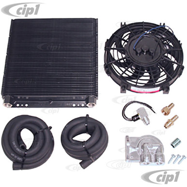

                              I have a 1979 XS11 standard and have been looking at figuring out a oil cooler for my bike. Are the fittings tapped directly into the oil pump housing in that picture? Also has anyone looked at getting a VW style oil cooler or is it too wide?
                              Like the one here:
                              When I first moved to California I bought an 69 Bug and it would have overheating problems sitting in LA traffic during the summer. There is nothing like an average speed of 20mph when you are traveling 35 miles. I installed a oil cooler and it solved a lot of those issues (except the traffic itself). One issue that was brought up earlier was about VW engines being air cooled and still lasting. The thing with that is that as long as the engine was running (and you hadn't thrown your alternator belt) there was always a fan blowing on the engine (heads espectially) which helped keep it from overheating (for the most part).
