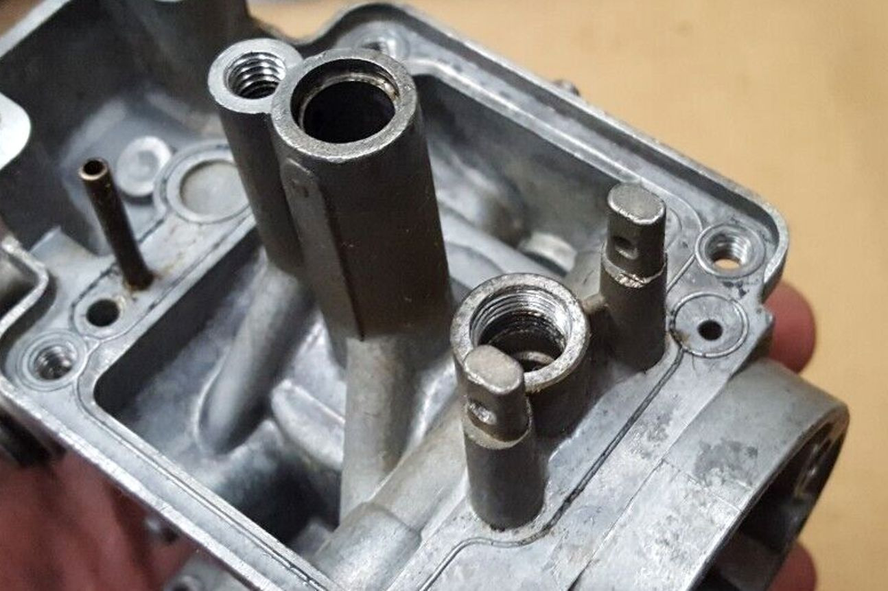

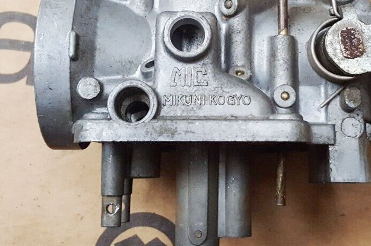

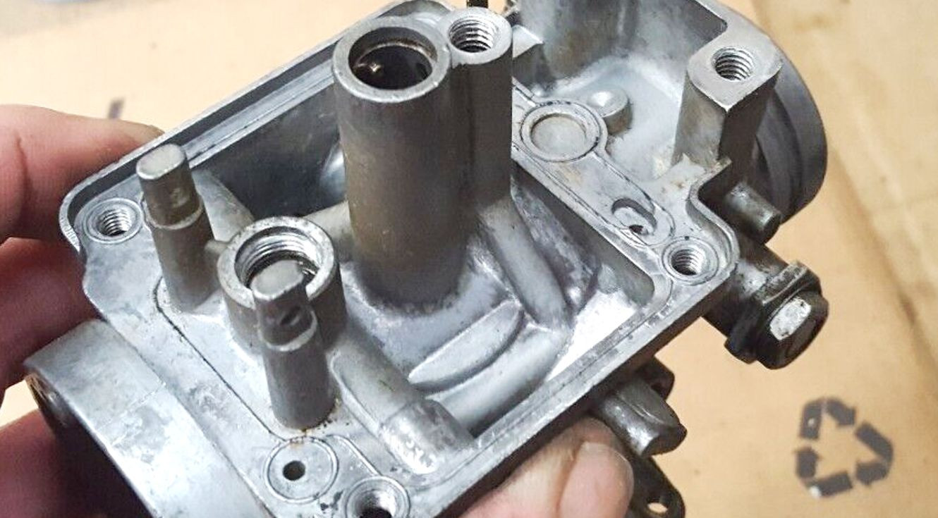

        Roger, I have been looking for a #1 XS1100 carb to repair your issue for several weeks. One popped up today:
        • roger
          • 52
          • al
          i seen that and just bought it. thanks for the heads up.
            • 2054
            Looks like something by the hole where the float pin goes into so be careful!
              • 1467
              Looks OK. Maybe a nick.

                • 1811
                If you buy replacement pins they just slide in and out loosely. They don't actually need to be press fitted because the carb bowl holds them in place anyway.
