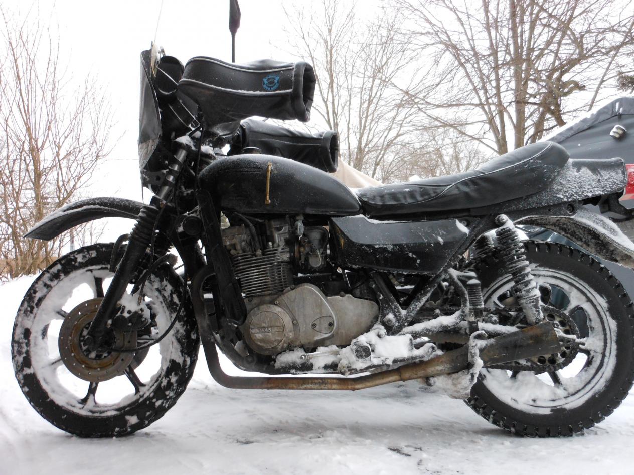

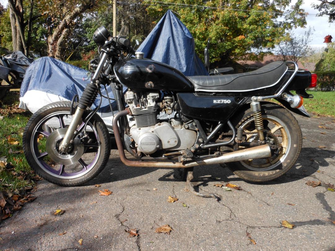

                      When you rock it back and fourth make sure you put it in 3rd gear so it has enough torque to break it free. If you do it in first it's like pushing a bolder uphill. Not good for the tranny. Also make sure the plugs are out and you have rags covering the spark plug holes. When she lets loose oil will come flying out. I did this with a 79 Kawi 750 twin and put 50,000 miles on afterwards. Bought the bike for $50.00 with a stuck motor at a tag sale.
