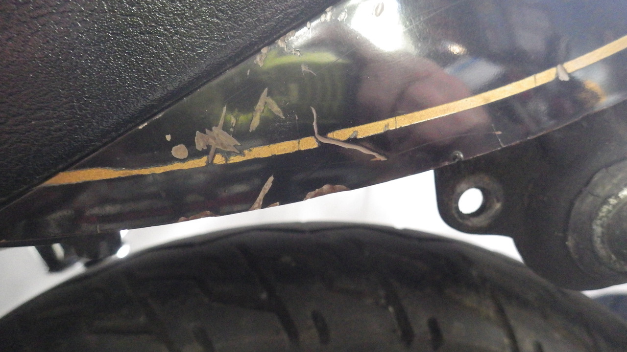

      The bike needs paint and decals.
      • The tank has a couple dings and some surface rust on the rear.
      • There are vertical stains on the front sides of the tank I assume are from brake fluid.
      • The replaced LEFT side cover is not in OEM black and has no decal
      • The RIGHT side cover needs a re-paint due to scratches and missing paint and the decal is crap.
      • The tail fin needs is in crap shape too.
      However, a wise friend once stated that "Paint is only OEM once". That said I don't think his paint was this bad.....

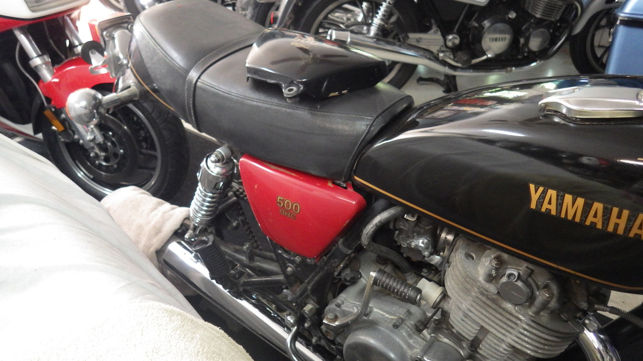

      Tank Rear Missing Paint from seat rubbing.
      Tail Fin Scratches & Gouges probably from tie-downs on the luggage rack.
      Right Side Cover Damage from the seat rubbing on it.
      Left Side Cover - Wrong color and it looks like the PO touched it while it was still wet.

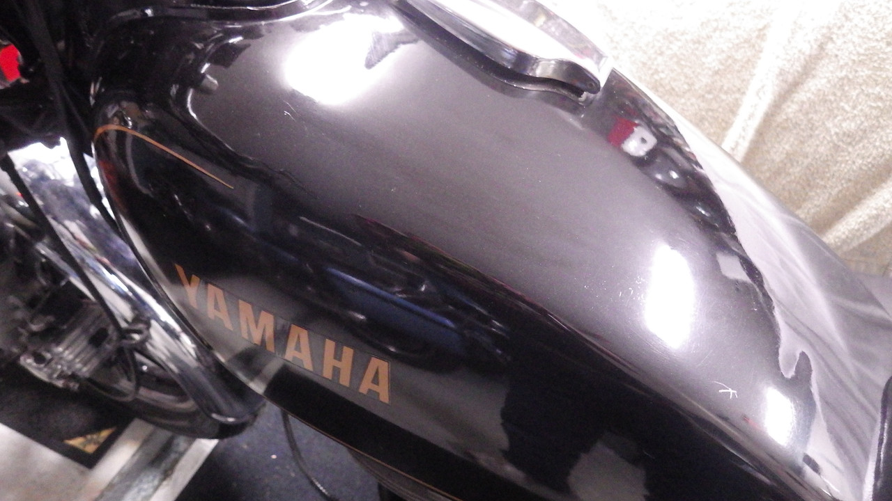

      I tried to polish the heck out of the tank (that's what all the white dots are all over the bike from my high-speed buffer and cutting compound). But in the sunlight, all the stains and drips on the front from the brake fluid are clearly visible...

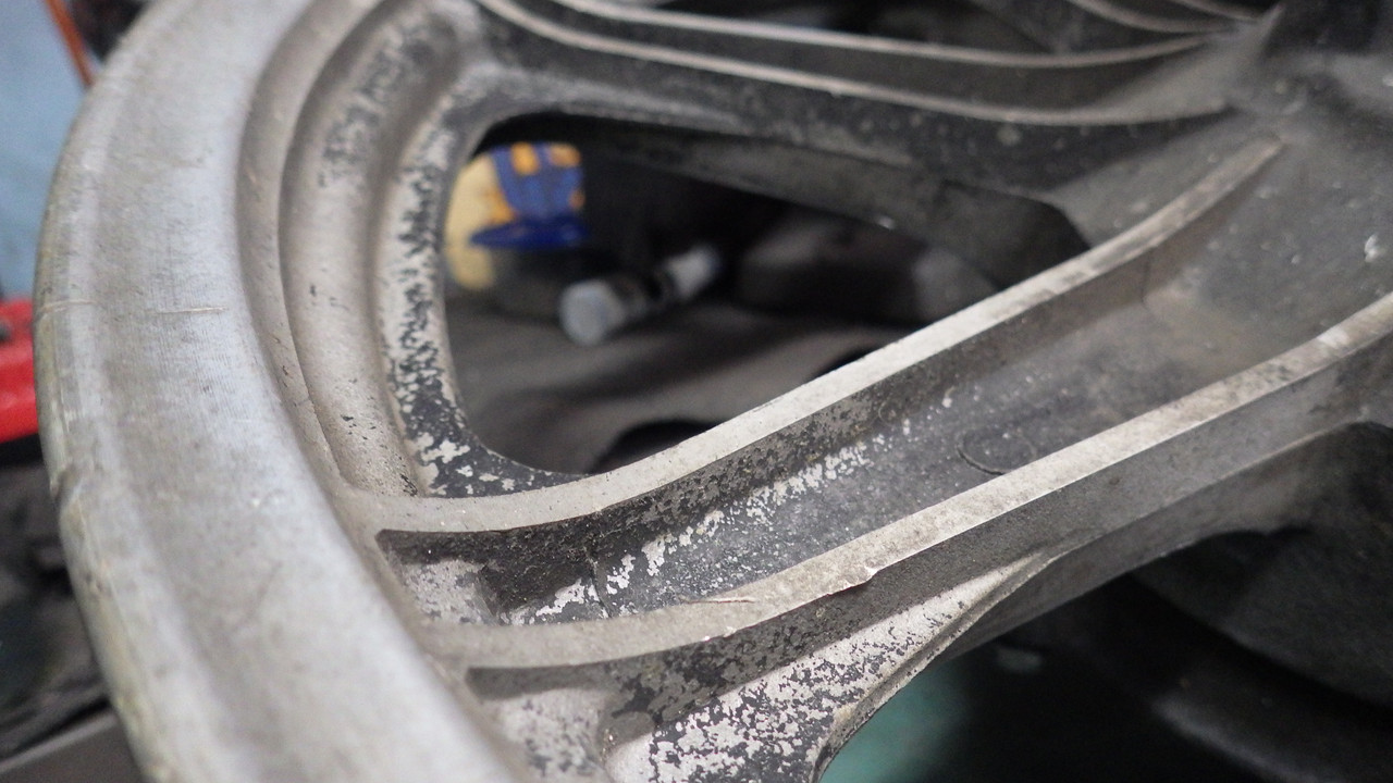

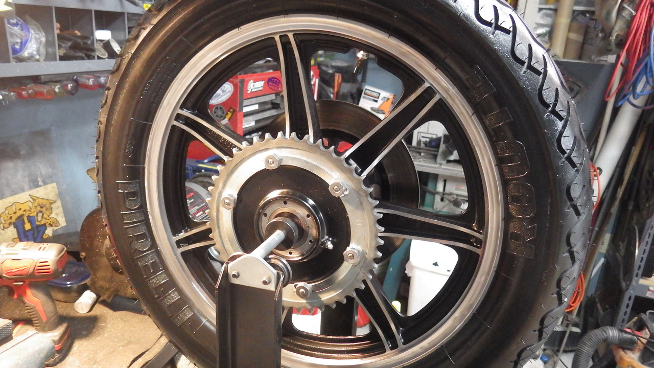

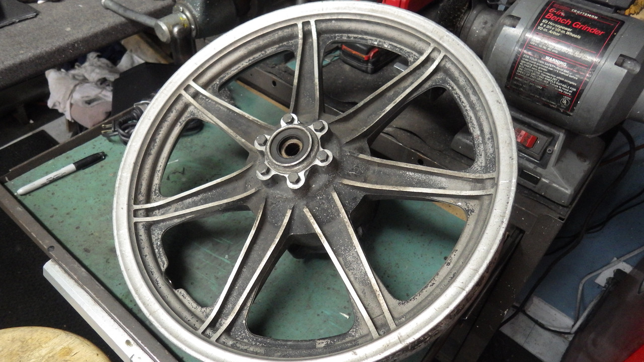

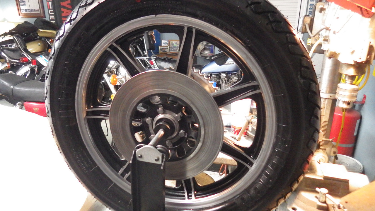

                  Rear rim is done: Cleaned, sanded & repainted, New Bearings, New Seals, New Bolt Locks/Retainers, New Tire (old tube), Properly Balanced, Polished (best possible), Rotor is marginal/questionable (looking for a replacement) READY 2 ROLL!
                  Rear Rim B&A
                  Kurt
                  1982 - CBX1000 - Honda
                    • 2001
                    Rear Rim B&A
                    Kurt
                    Awesome job. Looks great.

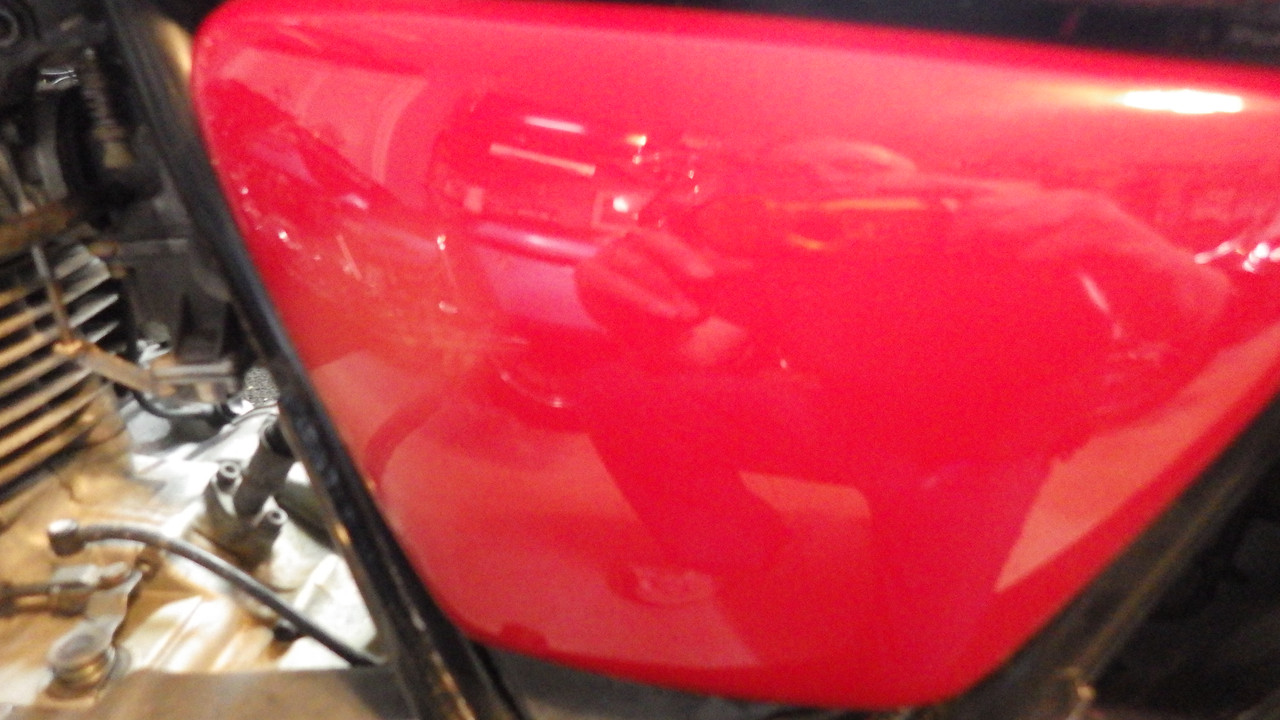

                        Getting closer to Yamaha "STAR RED"!

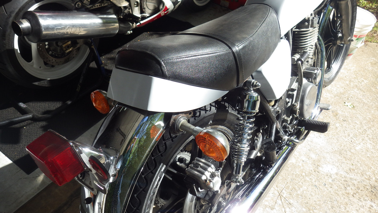

                        Fixed the minor dings in the tank, gouges in the tail fin, wear ribbon in the top of the R cover. All-in-all only took about two tablespoons of filler for all the repairs (80% of that was sanded off).
                        Then, three HEAVY coats of PPG 2K High Build Primer with wet sanding between each.
                        HOPEFULLY, get some color on it in a week or so.
                        Kurt
                          • 1259

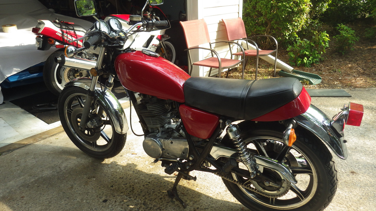

                          Color is on....Seems a little "Brighter" than the OEM sample I have but it's also not 43 year old paint... Close enough for my liking.
                          After a few days of drying, I'll likely sand and re-spray the tank as there are a few small defects. Only on the underside I have a couple fisheyes around the petcock area I didn't clean well enough. Then, it will dry for several weeks and get color sanded and buffed.
                          Unfortunately, I'm back to looking for decals again! The decals offered by Diablo Cycle are not correct for the Red version. They're actually not correct for either version as the gold letters are supposed to have a black border which few would notice (or possibly care about) on a black bike. Some of the guys on FaKeBook are suggesting a seller in Germany. Back on the hunt for the proper decals.

                                I managed to get the "Sand & Buff" completed early see photos! (little kid couldn't wait). Seems this may be the best paint I've EVER done on ANY of my bikes, I guess after 10+ bikes I've finally figured out the process!
