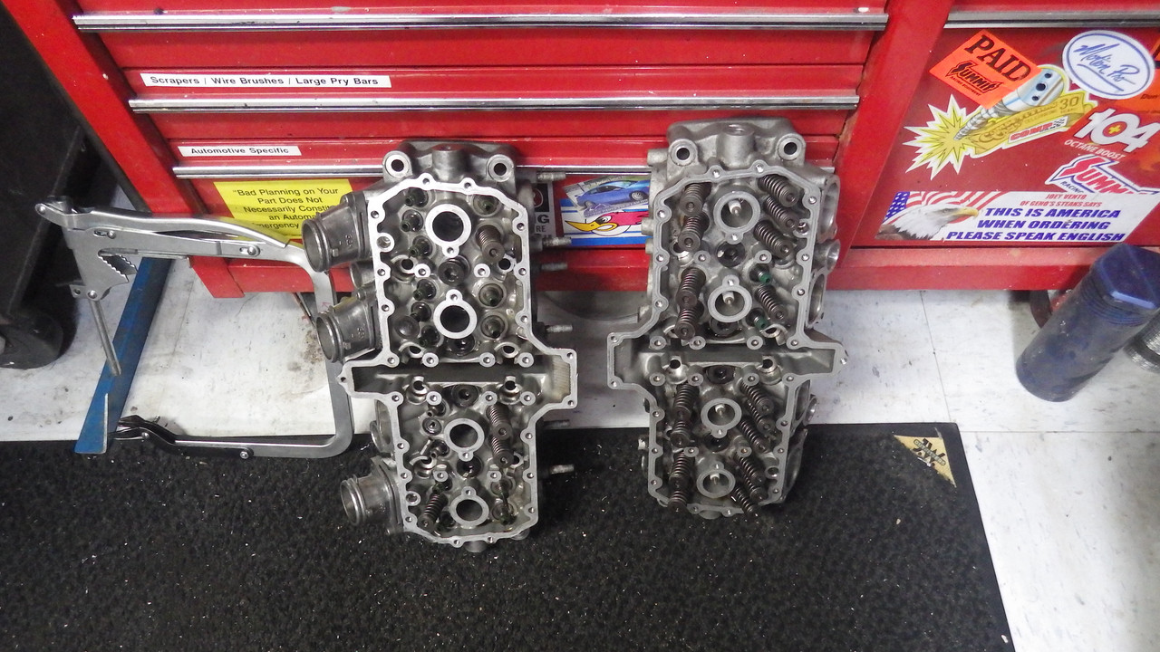

      FZR IS BLOWN UP... Rebuild finally beginning.
      Those that attend the Vintage Yamaha Rally are probably aware that I blew up the FZR last summer a couple months before the rally. The cam chain snapped and wrapped around the crank.
      I've been procrastinating the rebuild as the repair of a 21 valve machine (1 in the exhaust) was not a picnic I was looking forward to.....
      Fortunately (or unfortunately), I thought I had accumulated the necessary parts for what was sure to be a total mess and now it's time to get the ole' screamer going again.....

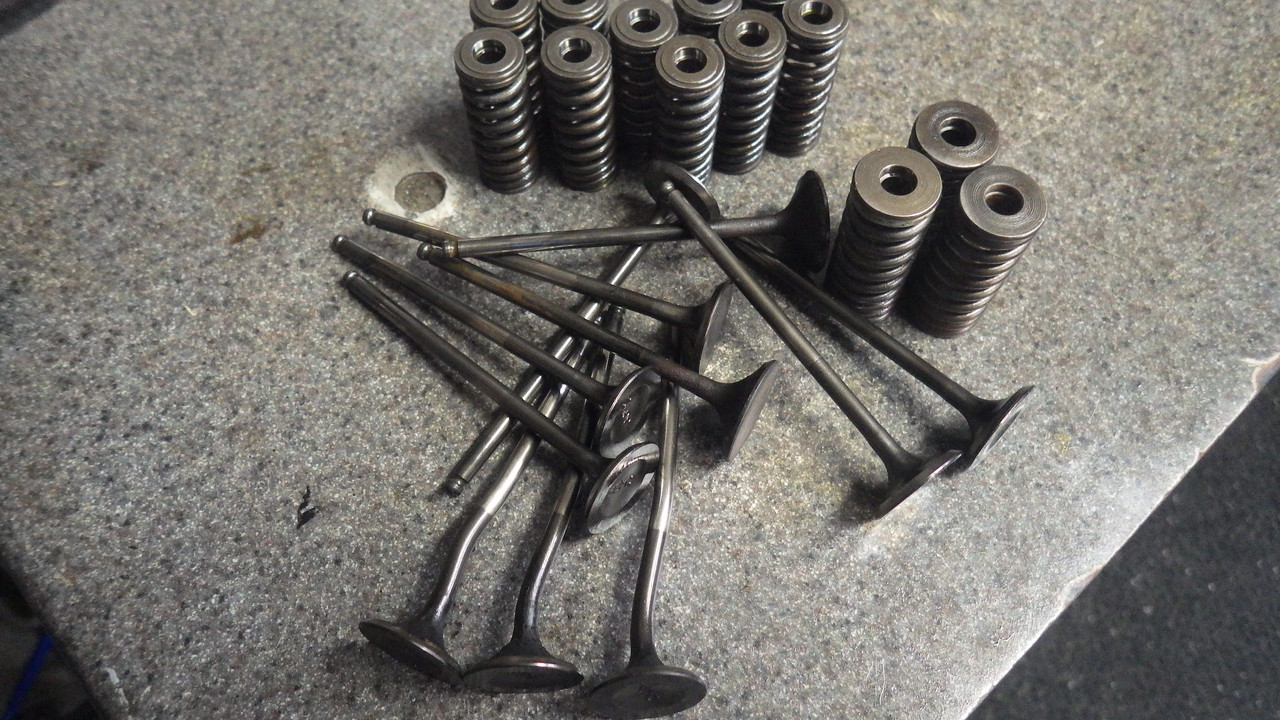

      I was expecting some valve damage but the CARNAGE is unreal. These valves are itsy-bitsy compared to the XS11 and extremely fragile. Obviously, at even an estimated measly 3k PRM, these valves smacking pistons when the chain snapped was going to create some havoc....
      Unfortunately, the "SPARE" head I purchased years ago wasn't too much better than mine. Actually, the only redeeming quality was it didn't have a snapped off valve guide! Almost all the valves in the "SPARE" were crap too!! On the fortunate side, I have enough good exhaust valves and enough of the center intake valves (these are different dimension than the outers). I've purchased all new outers from Part Shark at ~$25/ea. I HOPE show up quickly as the YZF1000 uses the same valves (fingers are crossed!). All the valves will be pulled out again and lapped in v-e-r-y l-i-g-h-t-l-y.
      I don't see any piston damage but I have a spare set of used OEM standard pistons and a set of jugs.....
      I thought of going LOW BUDGET but am having some second thoughts..... While I'm in here a bottle brush hone an a new set of rings will likely be the order of business. I am NOT going after the bottom end as there does not seem to be anything to indicate a problem there. Yes, this move could be considered "Half-Arse" but the availability of new bearings is the biggest concern... Bearings for this thing are like trying to find a '79 Special rear pull bar!...BUT WORSE AVAILABILITY!

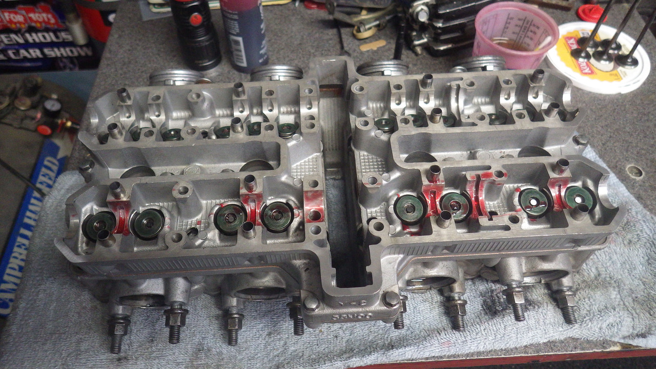

        FINALLY! I received the last needed replacement valves from YAMAHA!
        All the valves are installed, lapped, and leak checked! What a PITA - 20 VALVES! (+ one in the Exhaust Pipe)

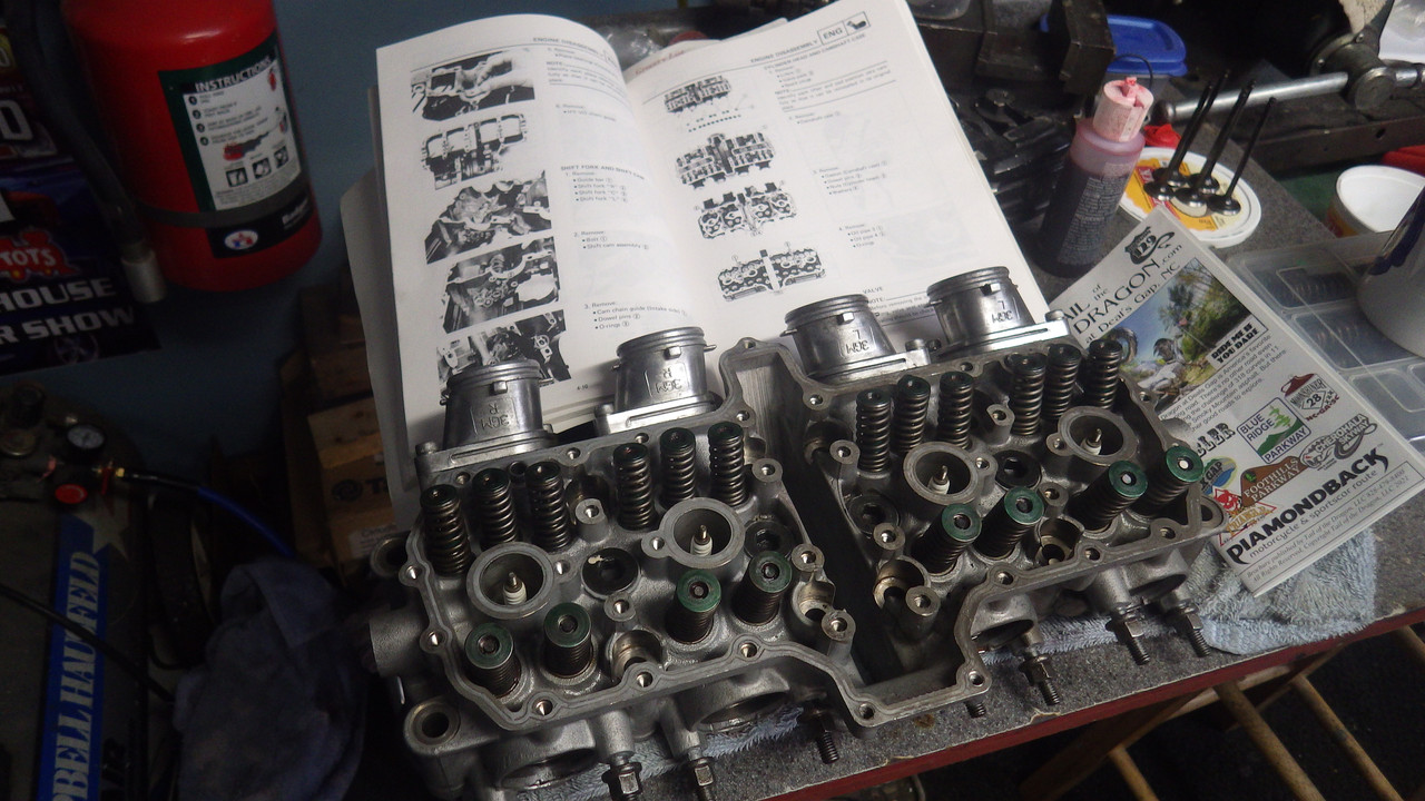

        Now, one side (either exhaust or intake) must have all the valves on that side pulled to install the cam case/carrier.
        Cam case installed, exhaust valves re-installed. Getting ready to install some shims check clearances, then adjust, then remove the cam and do the other side.
        Exhaust Side is done and adjusted to spec. However, this will require a re-check once ready to fire and then again after a good run-in.
        Using a spreadsheet to help track for future reference and to allow the MATH to be completed by the program to determine the best fitting shim.

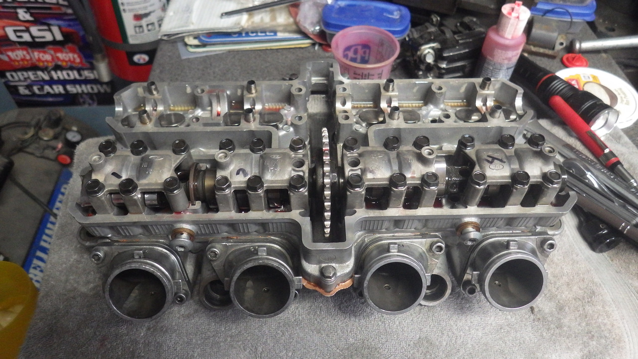

                  Got the head back on....
                  Checked all the Intakes, pulled the intake cam, make the necessary shim adjustments, decided I had enough time to install the head.
                  Now, with the head in place, I can clean-up the small garage a little bit
                  • Head Pipes and Muffler can be installed.
                  • ExUp Cables can be installed.
                  • Radiator, Fan, & Hoses can be installed.
                  • Rear head water passages and thermostat housing can go on.
                  • Oil Lines to head can go on.
                  • Some of the wiring can be placed back where it belongs
                  • Mounts from the head to the Perimeter Frame can be re-installed.
                  • All the motor mounts can be properly torqued (loosened to remove the jugs).
                  • Carbs could maybe go on....But the throttle cables have to be installed with carbs off and the cables will be in the way of the remaining top end work & alignments.
                  Getting all that crap back on the 2 wheels will make some room for other necessary work and work on the XS850.

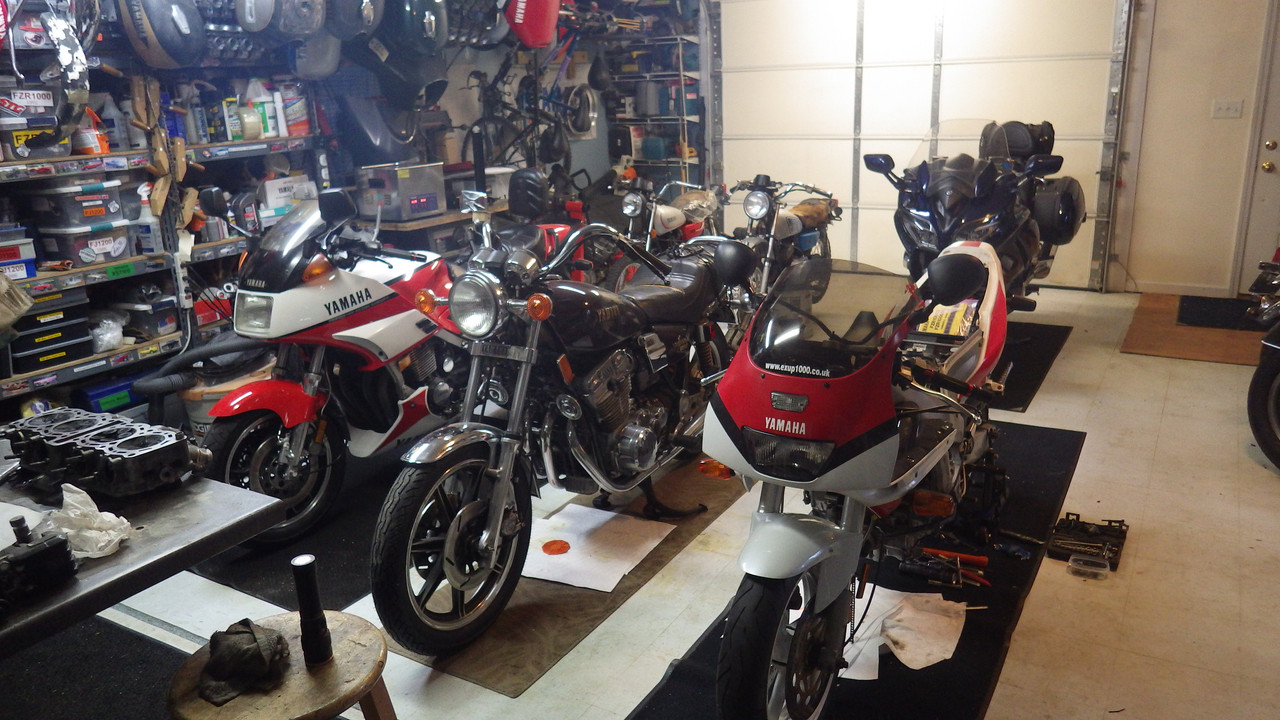

                      She's back in service and running as well as ever...... I trust you. Honestly, couldn't give a crap about the bike as long as no one gets hurt. This ole' girl will be at the Vintage Yamaha Rally 2023. Keys are yours to enjoy!
                      She's back in the "Line-Up" ready to go with the press of the starter.....
