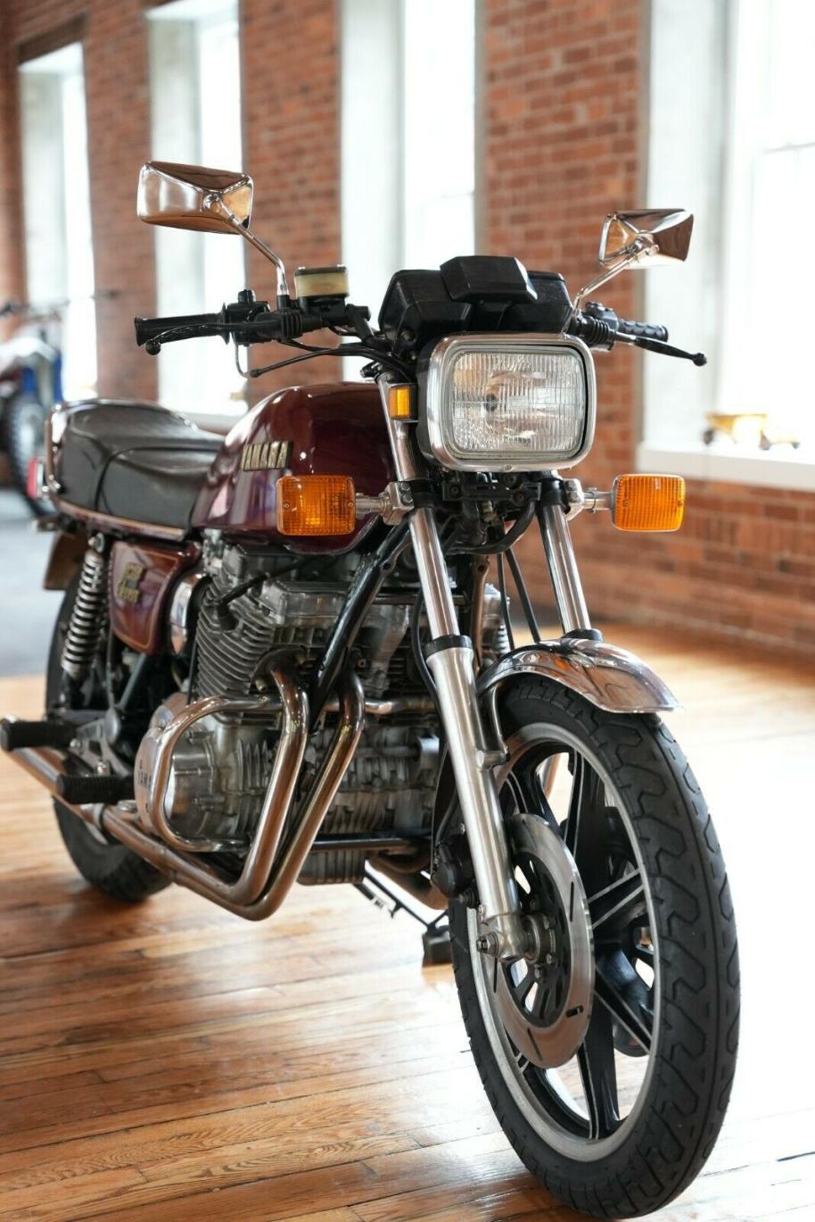

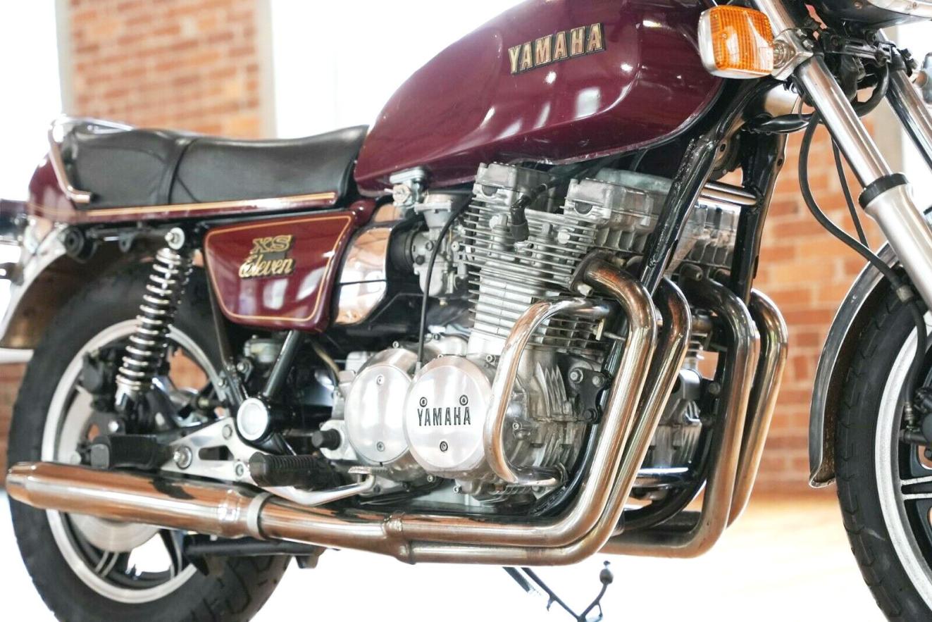

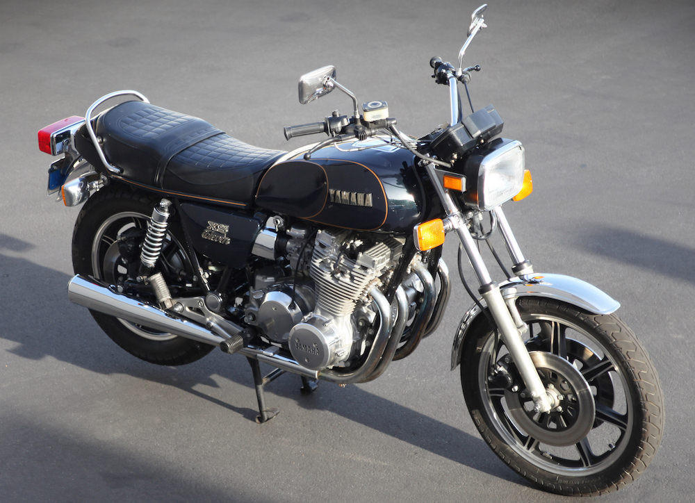

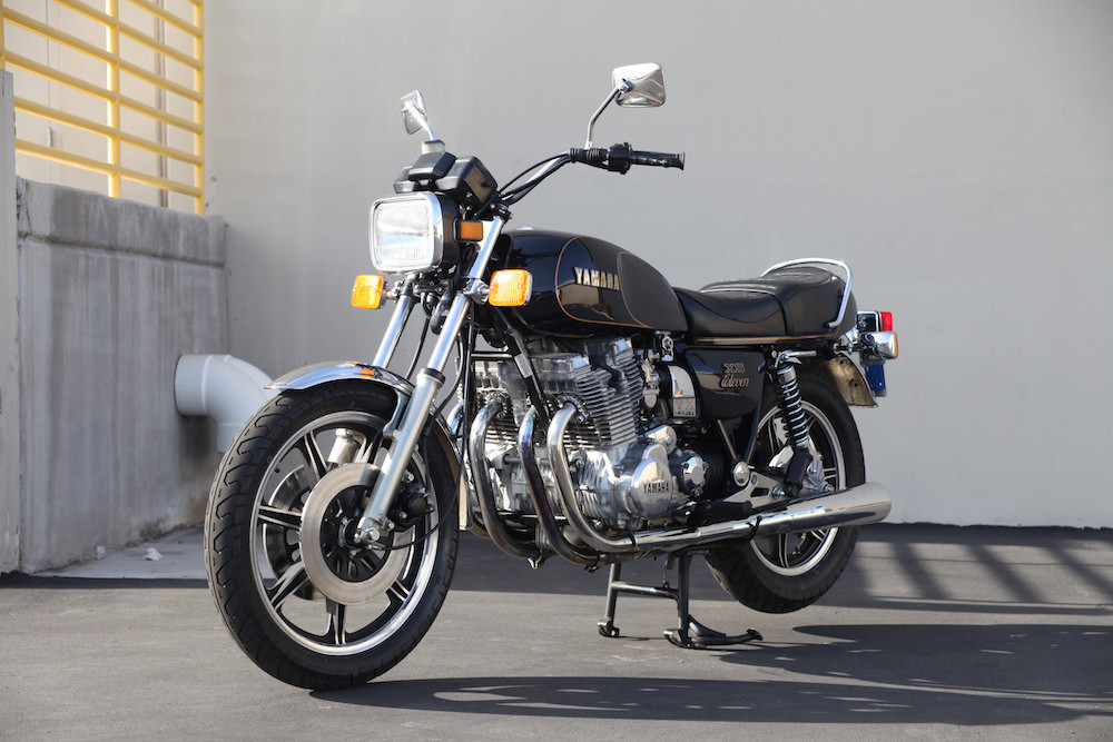

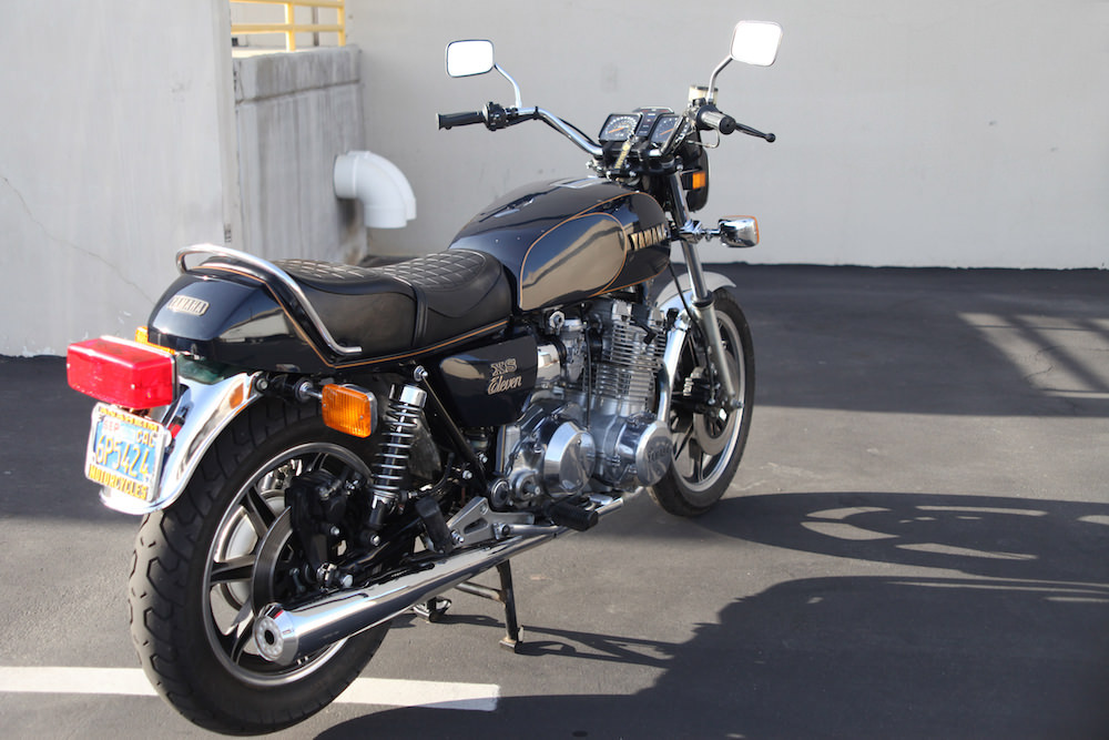

              • 2090
              Stock.....
ID:	891309 Click image for larger version
ID:	891310 Click image for larger version
ID:	891311 Click image for larger version

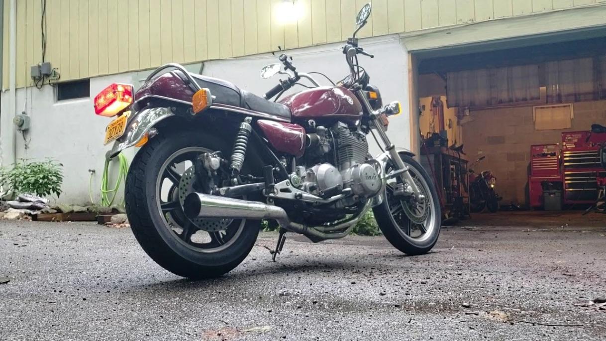

                • 2090
                MAC made 2 versions. 4 into 2 (which I run on my bike). Great oil filter and cam chain tensioner access.
                Click image for larger version  Name:	2.jpg Views:	0 Size:	173.3 KB ID:	891314 Click image for larger version  Name:	5.b.jpg Views:	0 Size:	166.8 KB ID:	891315 Click image for larger version  Name:	3.jpg Views:	0 Size:	159.3 KB ID:	891316

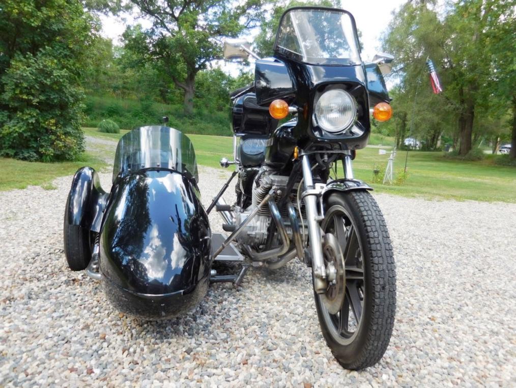

                  • 2090
                  And the 4 into 1 that has been discussed here.
ID:	891321 Click image for larger version
ID:	891318 Click image for larger version
ID:	891319 Click image for larger version

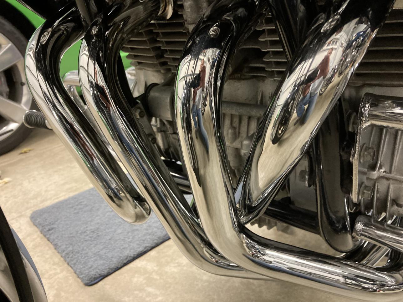

                        • 2162
                        I stumbled across an NOS Jardine spaghetti.

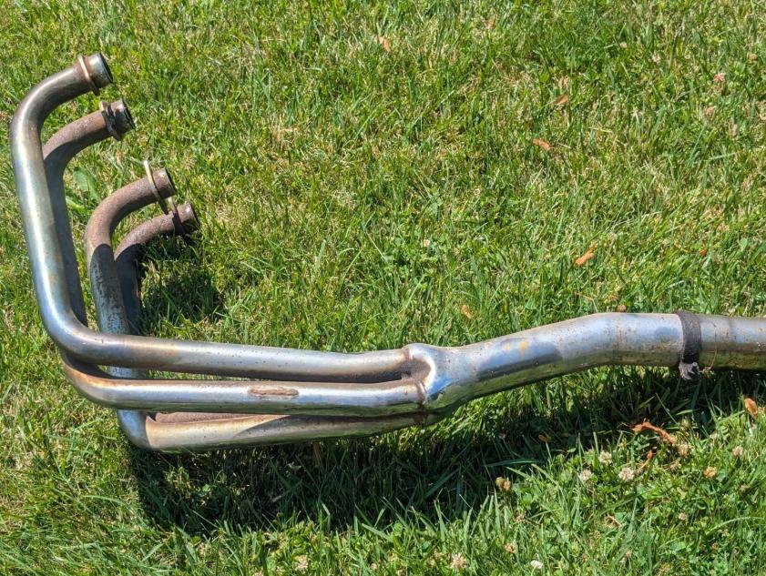

                        • motorhead13
                          • Jun 2025
                          • 9
                          Thanks for all the info and pics, cool looking bikes.
                          The exhaust I have is some old weird looking black thing (its all black, slightly rust tinged) and is off the bike at the moment. I'll try and get a pic of the bits. I've seen that Delvic one and looks pretty good, my concern is ground clearance.
