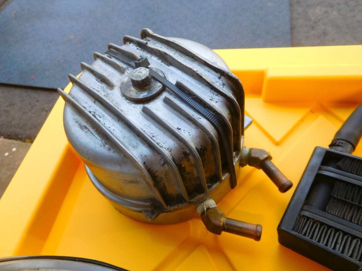

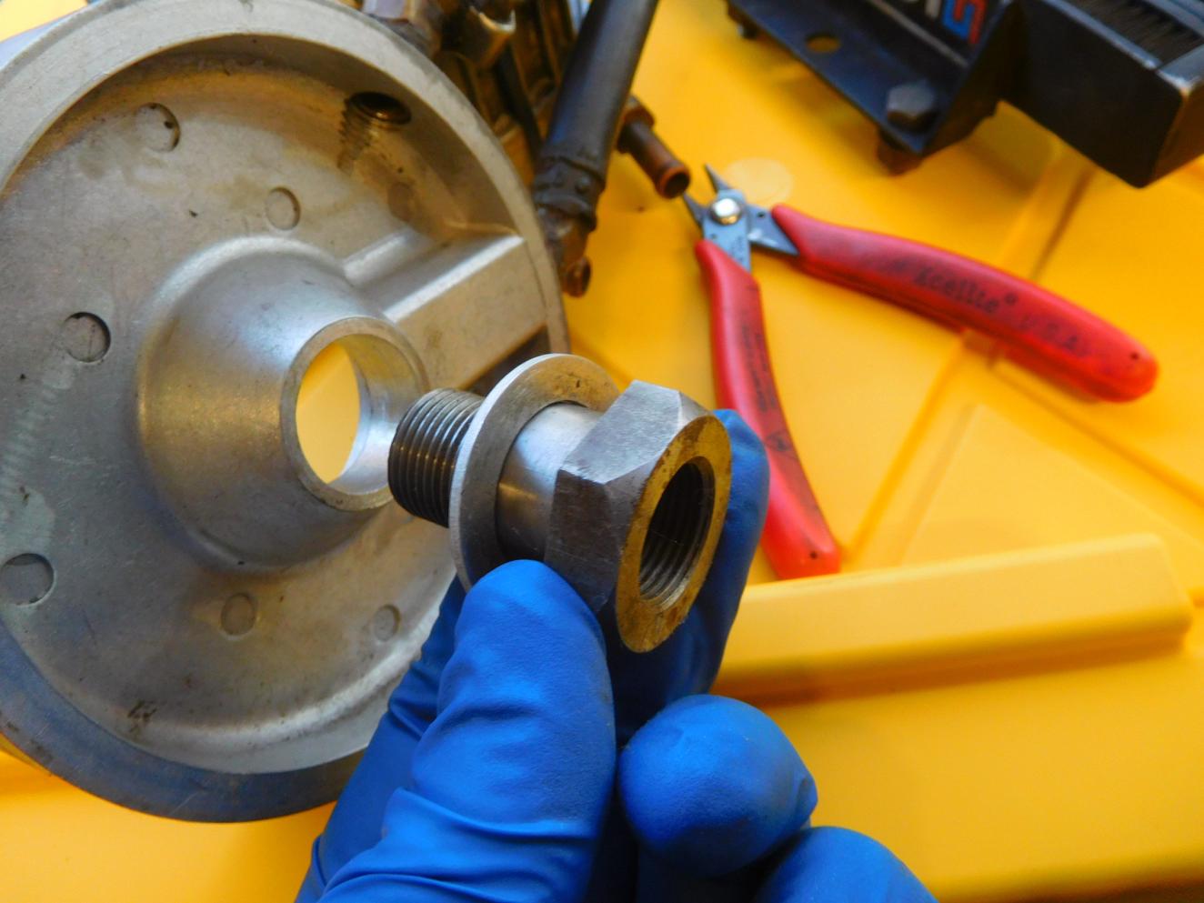

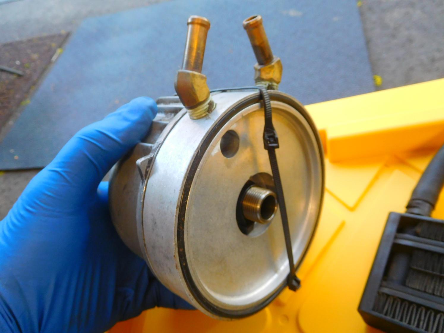

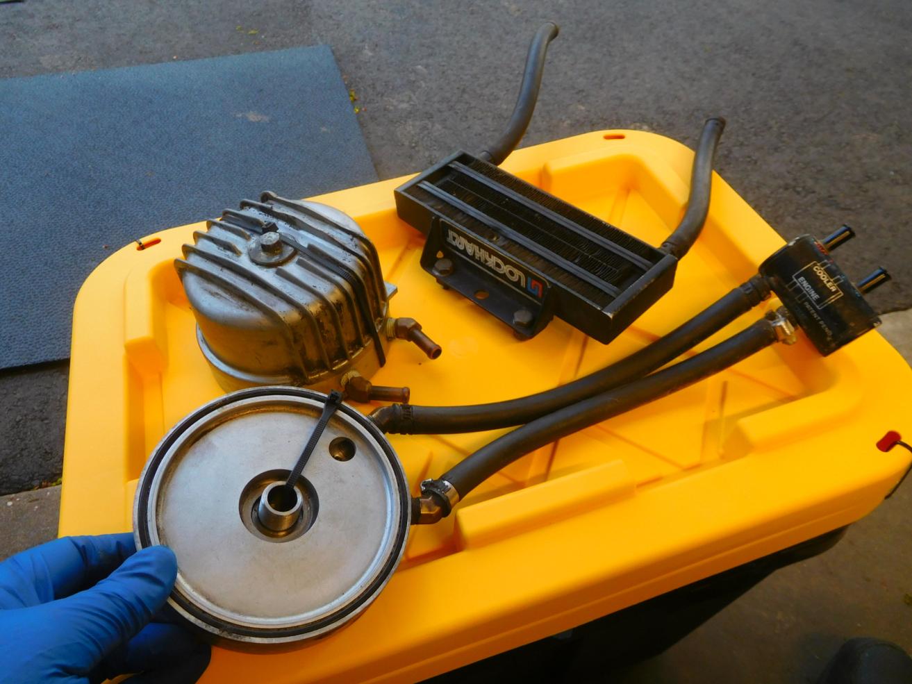

    LoftCol, I believe you may have another issue with converting. The plate is sometimes worthless without the extended mount bolt depending on the adapter. I see these things for sale all the time without the extension bolt. Your stock bolt possibly won't reach because of the added thickness.

      Footnote: In your climate, the XS11 does not really need an oil cooler. The motor might not reach temperature enough to burn off condensation. It would need at least a thermostat mounted in-line. Then you would be surprised how the oil cooler would never even get warm due to the engine never reaching a high enough temperature to open the thermostat. I have run into this myself with a KZ1000. I ended taking the thing off. You may need it in Arizona with Larry.

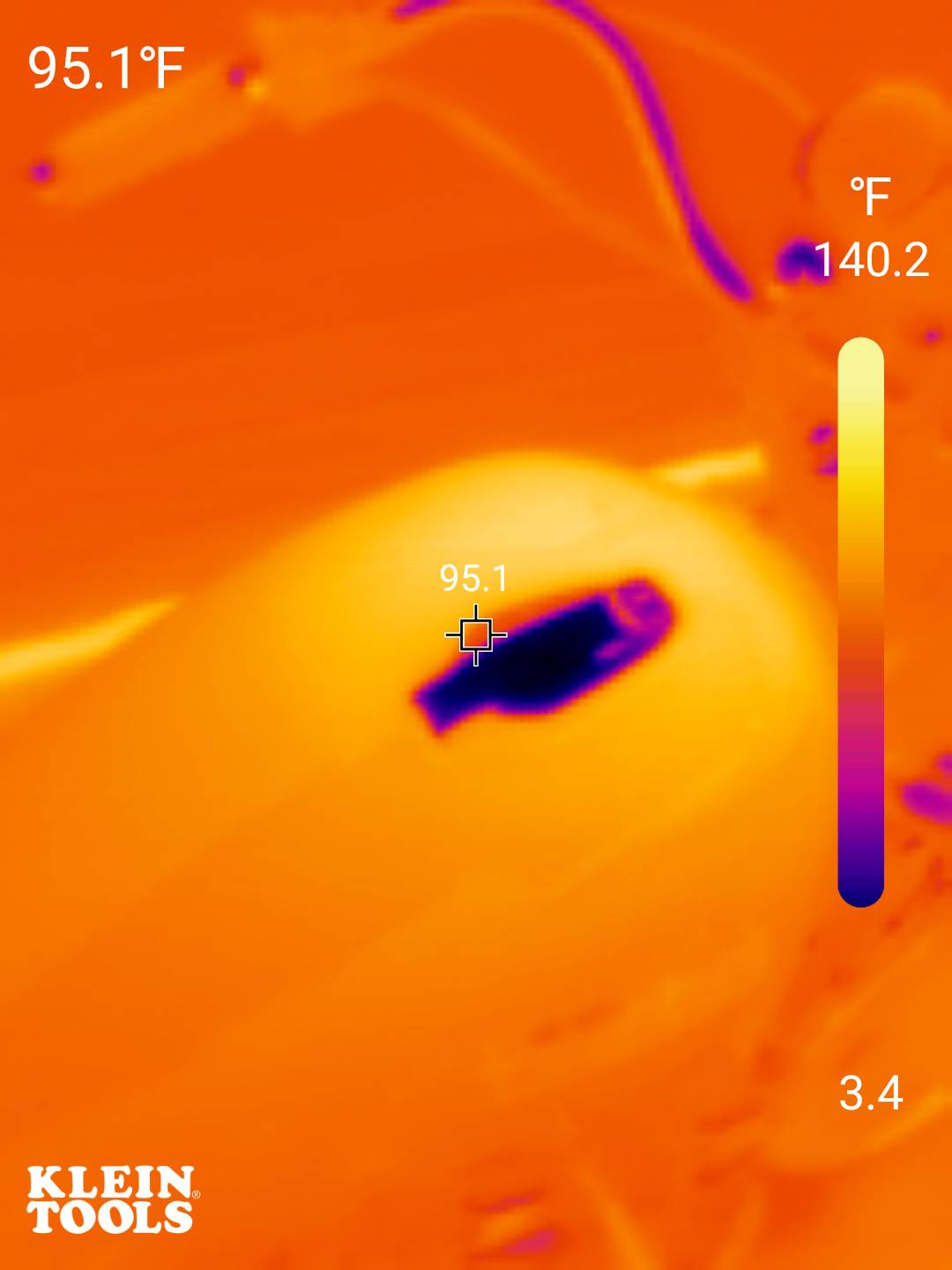

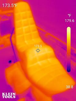

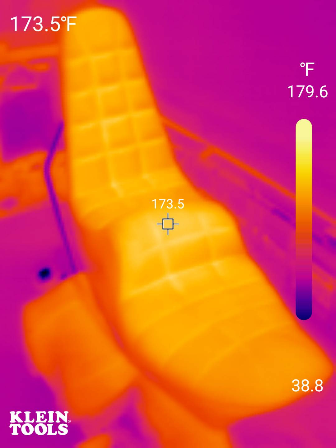

                Even WITH an oil cooler I'd be dealing wit' other factors that would make riding in the summer heat a non-starter. (ᗒᗣᗕ)՞
ID:	888777 Click image for larger version
ID:	888778 Click image for larger version
                This is just with the bike sitting out in the Arizona sun fOaR an hour.... (⊙︿⊙)
                Black tank and a black seat.... ( `_ゝ´)
                LoftCol.... be glad you don't smell something like bologna in a frying pan when you sit down fOaR a ride. (´;︵;`)

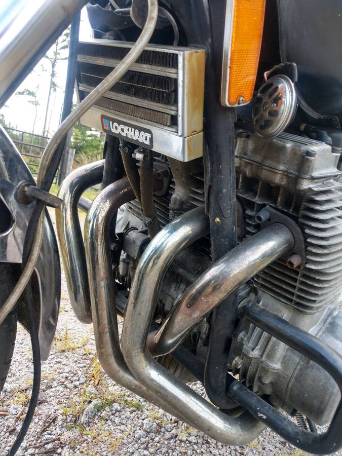

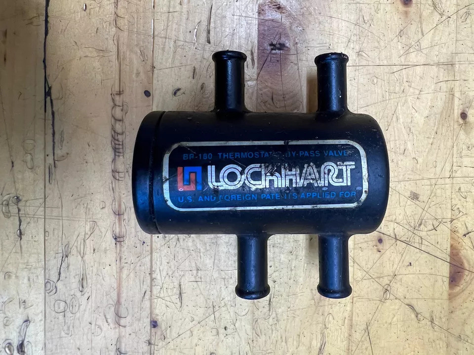

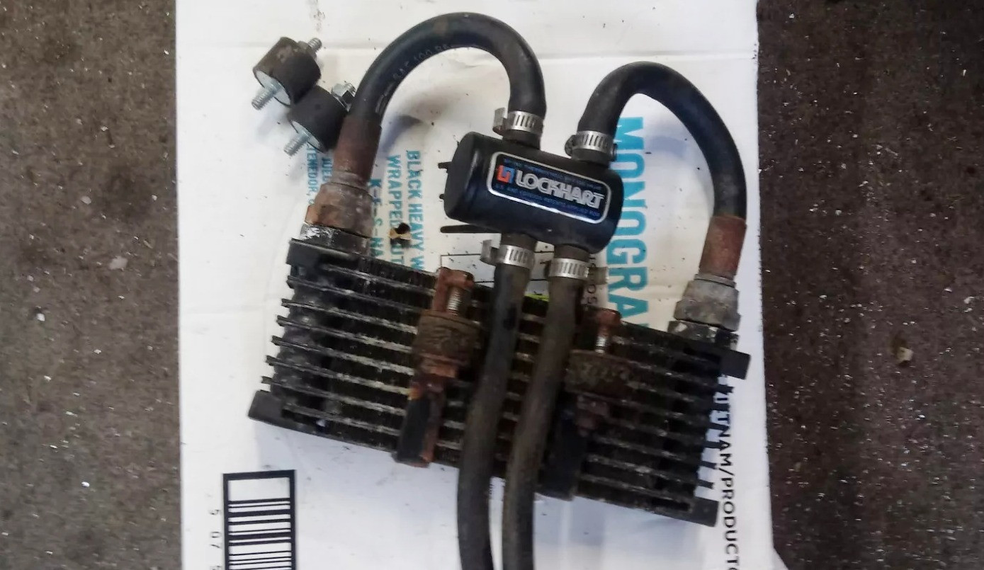

                  When I first purchased my new to me 1980 LG I bought that Lockhart cooler and ran it for a few years. I actually still have it. I remember something about two bolts and mounting spots at the top of the cooler line up with two mounting spots on the front of the frame that are already threaded to accept said bolts. At least they are there on all three of my MNS's. I spent 2 years in England while in the USAF and I remember the summers were not really too hot so I would have to say an oil cooler would be overkill.
                    The Special I ride now has an oil cooler on it. Unlike years past, I no longer ride when it gets too cold so I'm just leaving the cooler on. I DO live in the high desert in the Boise area, so that is a factor. I did have an oil cooler AND a gauge on my first XS, the '78 dresser. Riding through the Central Valley of California I could see the oil temp go up quickly. Cooler kept the temps at about 275 to 320F, and that worked for me. I do agree that the UK only gets hot a few days per years, so a cooler is not really needed UNLESS you spend a lot of time in slow traffic. But then, I've been to the UK in November for a week, and just a few days in the spring and summer.

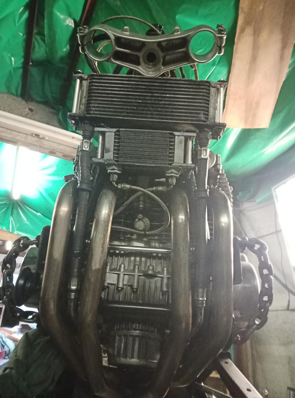

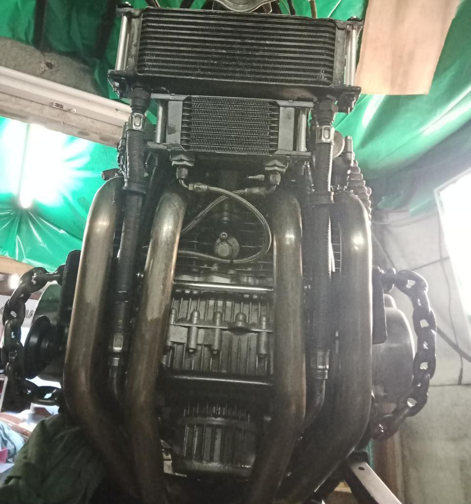

                      I've seen 130°c on the cylinders in the uk.Weather means nothing.I run a separate head cooler and a larger oil cooler this lets me put about another litre of oil in it.

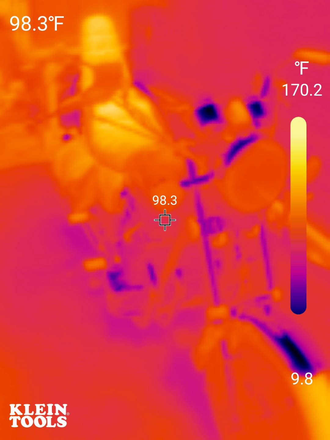

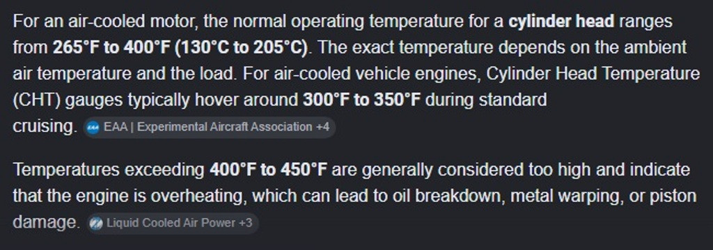

                          I like your crash bars. If I am not mistaken, the smaller/lower cooler processes the pressurized oil from the orifice under the carbs that feeds the cams in the head. That is an unnecessary area to cool (especially with your existing oil filter adapter cooler) and can reduce the needed pressure to the cams. 266 degrees Fahrenheit at the heads of an air cooled engine are normal temps son. Cooling is unnecessary and you are in danger of reducing the oil feed to your cams.

                            It's only done 30,000 miles like it so far.And I run an oil pressure gauge so I know what the pressure is always 😉
                              • 2090
                              You seem to know what your doing.
